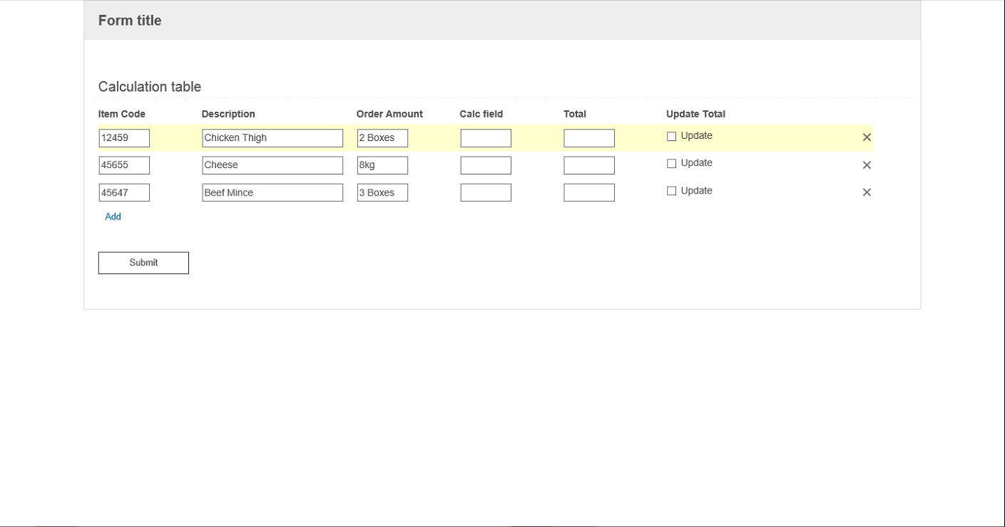

For an example of what they want is:
The customer wants 2 Boxes of Chicken Thigh but when it goes to the Picker he will weigh the boxes as they work off weight not amount. Instead of having a separate calculator we want to include the calculator in the Table.
To give you a bit of an idea I have attached an example of the form.
The picker needs to enter an amount/weight into the "Calc Field" then press the "update checkbox" for that row.
This should add the "Calc field" amount to the "Total" field
The "Calc Field" should then be automatically cleared and the Update Checkbox automatically set back to Unticked.
This allows the Picker to add another amount to the Calc Field to update the Running Total for that item.

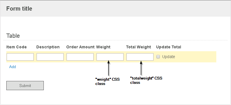

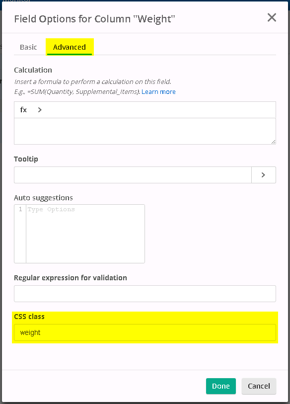

First, you need to add the "weight" and "totalweight" CSS classes to you table columns:
You can add classes like so:
Use this code to make the form work:

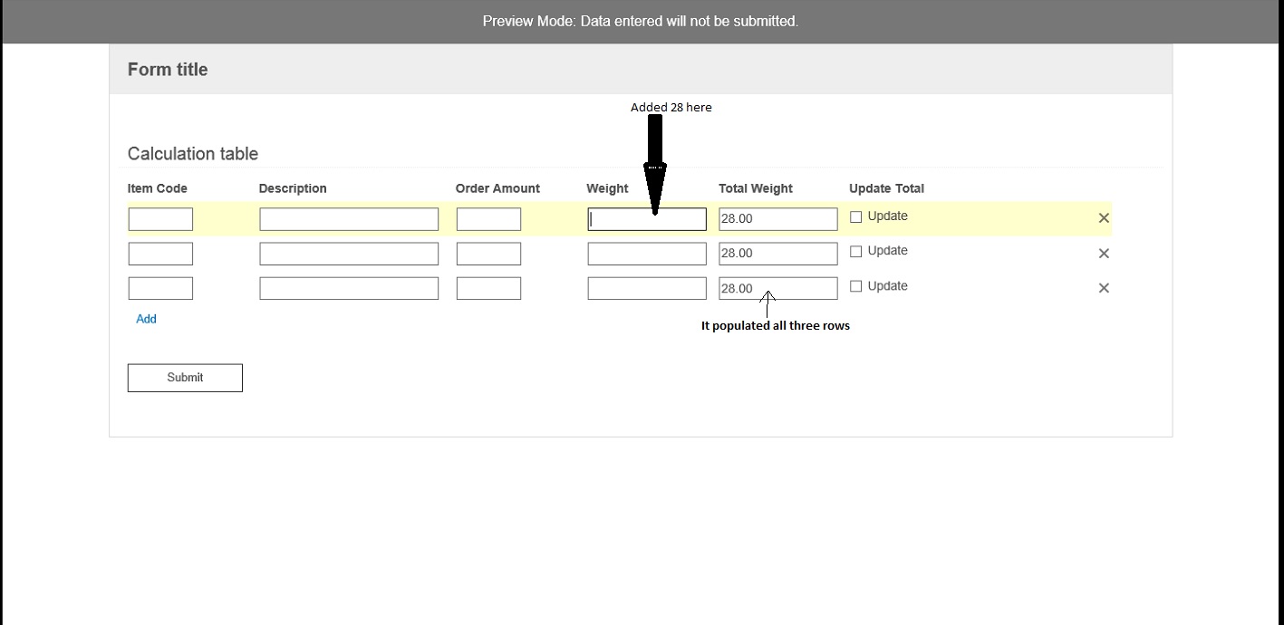

replied on July 18, 2017
That's awesome Rob, thank you, just one thing I found is if there are multiple rows and you add an amount to the first one it is adding it to Total weight in every row, is it possible to populate just that row? See attached
Thanks again for your help so far yes
