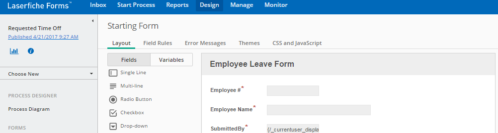

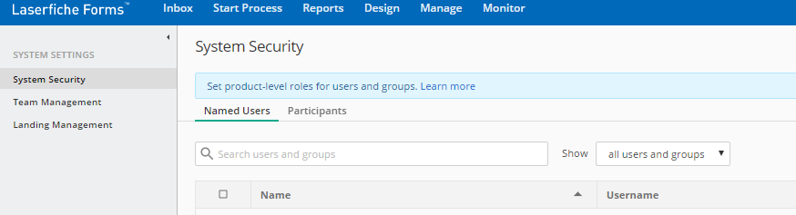

This past weekend, I migrated our Laserfiche server to a new server.  Initially I thought that everything migrated without issue, however, Forms is missing the lookup capability.  On the form configuration page, the lookup tab is missing as is the Data Source option on the administration page.  I am at a loss as to how/why this could happen as I have no error messages on the server event logs and everything else seemingly is working properly.  Any ideas???
