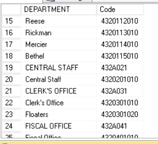

Hi Mark, thanks for the quick response. We are using version 10.2. Department name is a list and some departments are listed twice once in all CAPS and again normally. One department number is used for budget request and the other when the funds are expended. In the client if I select a department that is listed twice I have the option using a drop-down to select the appropriate value.

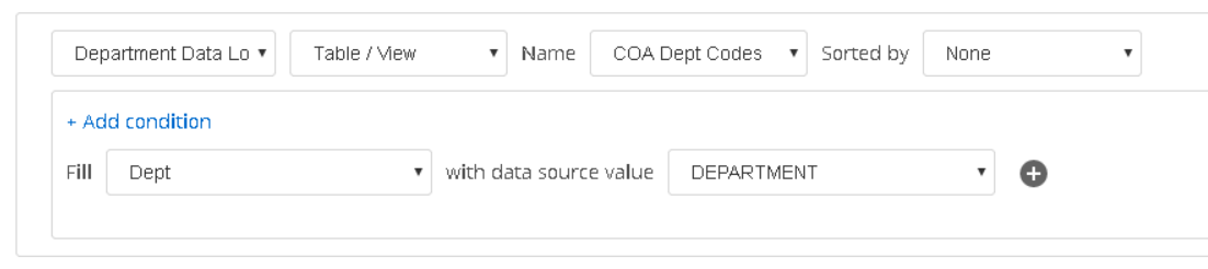

What values appear in your drop-down with this lookup?
The current rule has no "When" condition should it should be filling that drop-down with every value in the DEPARTMENT column.
If you're not seeing anything, then the data source/lookup is not working properly.

I see all the values in the department list. The issue is that if the there are two matching departments the corresponding code values are not presented (in a drop down) as happens in the LF client. The user has to then lookup the value and type it in. This is what I need a fix for so that it either creates a dynamic drop down as happens in the LF client or a pop-out so the user can select the correct value. I hope this makes sense.

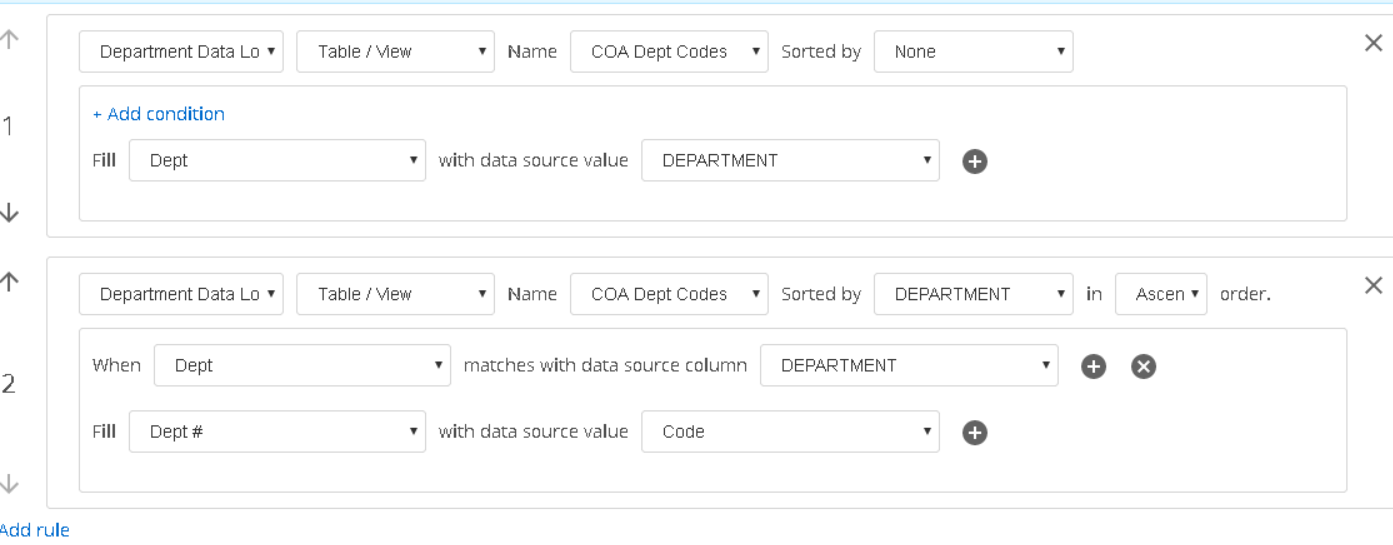

There is no lookup for the Code column. These are the only two lookups present. The first one populates the department values in the drop-down, the second populates the code based on the department value selected.
replied on July 18, 2017
Right, the lookup for the code is what I meant. The first thing I would suggest you test is adding a Drop-Down field with the same lookup as the Dept # field.
That way you can verify that it is actually giving you the results you're expecting.

You are absolutely correct, after replacing the field with a a drop down I am now getting the option to select the appropriate value. Lesson learnt, if the lookup column has duplicate values then the field that is being populated must be a drop down field.

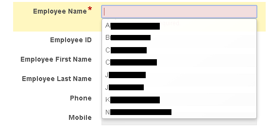

I have a form that uses a single line field and it works. The key difference is that it will allow free form inputs and you probably don't want that.
In that screen shot I posted earlier, I have a lookup (single line field) that returns multiple results, and creates a pop-up when you put the cursor in it.
If you're not getting the same results, you could try and test it in a different browser to see if that might be why.
