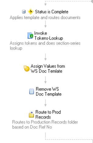

John, yes, it was an access rights issue with the Workflow user which we corrected during the test.  I was able to modify my production workflow to correct the issue by removing the first template then assigning the second as part of the save to repository step.  See attached.
