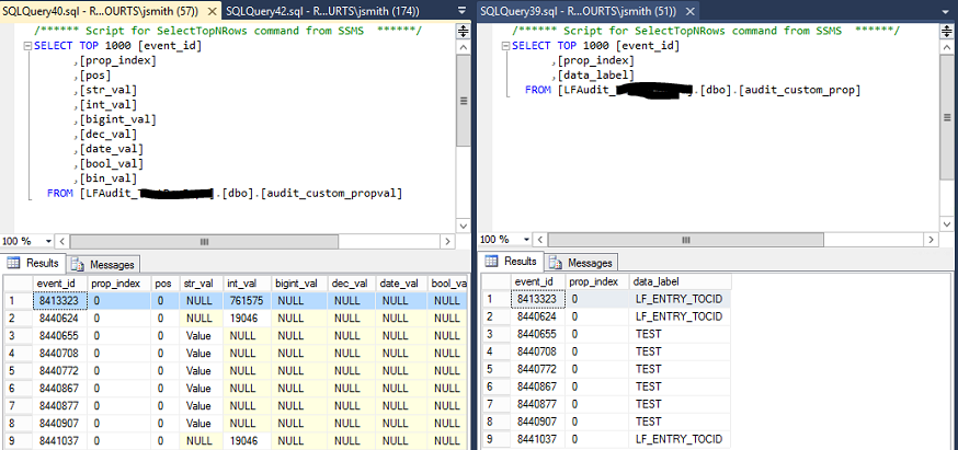

I've tested the .NET version of the CustomAuditEvent, but Audit Trail is not showing any of the custom audit event class information.
Additionally, when I attempt to add both a description and an Entry, it will only include the first one added in the database (only prop_index is 0).

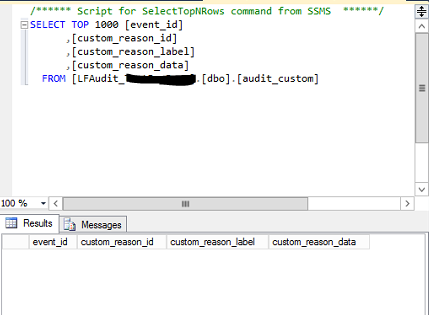

The audit_custom table seems to be empty. When I execute the code and log the custom event ID I get a value, but it doesn't appear to be logging it in the database, which I'm assuming is why the reports don't show any additional data.
