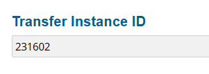

I have been trying to do the same thing and have had the same results, so I tried a different tactic.  I added the instance ID in the label of a field.  When I do that it shows on my form.  See screenshots enclosed.

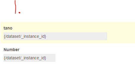

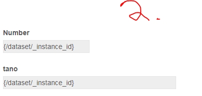

Yes facing the same problem.  I tried to do as you recommended and create a "single line" field and also tried it with the Number field and make "{/dataset/_instance_id} as the default value in both these fields in the initial form When the initial form is submitted, then I assign the the second form to the  reviewer and use these same fields to grab the value.  On the second form, I tried with the default value still in it and with out the default value in it and it still doesn't display.  I have version 10.3.1.553
