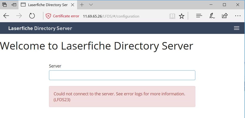

Good Day All
When I try to log in to Directory server I get this error as per screen shot.
The user was added to the Security Groups in Directory Server. Event Viewer gives me the following error

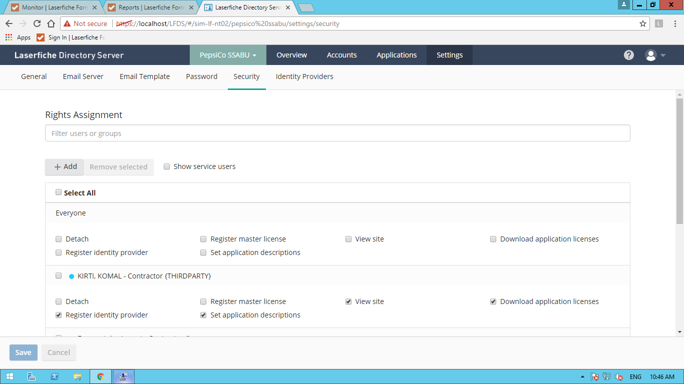

Can anyone log in to the Directory Server web administration page right now?
There are several layers to Directory Server security. Where did you grant the user access?
replied on July 14, 2017 • Show version history

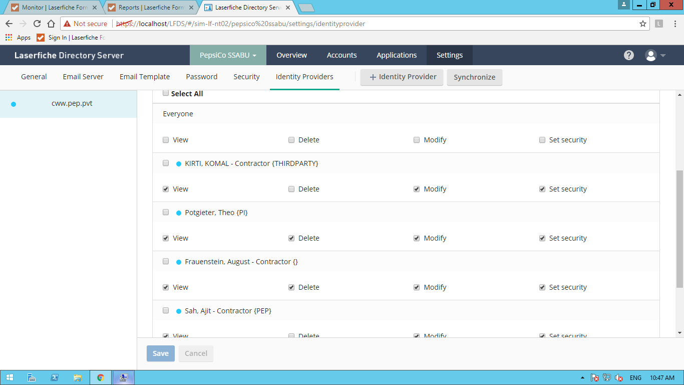

Hello Brianna
Settings\Security and Settings Identity Providers\Security
Screen Shots Attached
Yes I can log in with my account, but i need other admins to log in as well
Those settings look correct. You mentioned that they wish to perform remote administration, but I noticed that all the screenshots from your last post are localhost
Are you able to view the site when you are not on the machine where Directory Server is installed? Basically, I want to know if it's how they are accessing the machine that is causing the difference.
Yes i log on to the server where directory server is installed to get those screen shots.
For the other users from their pc we send a link http://11.69.65.26/LFDS
for them to connect to, that is when the error happens.
If i use my account to log in it is 100%, but not any of the other accounts.
