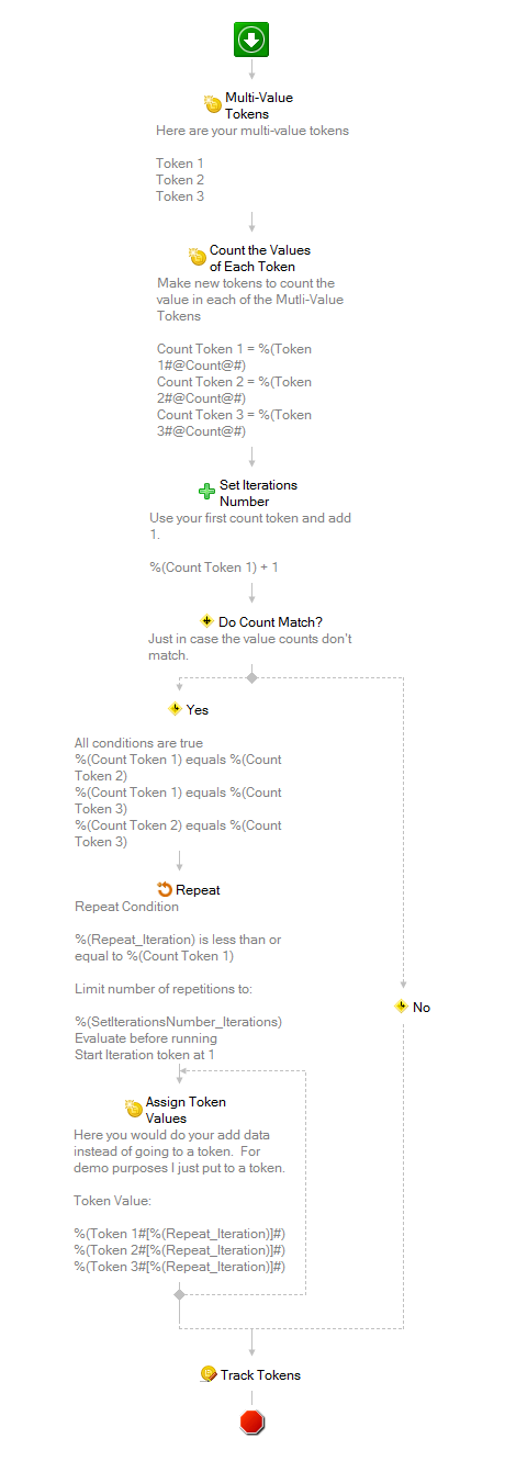

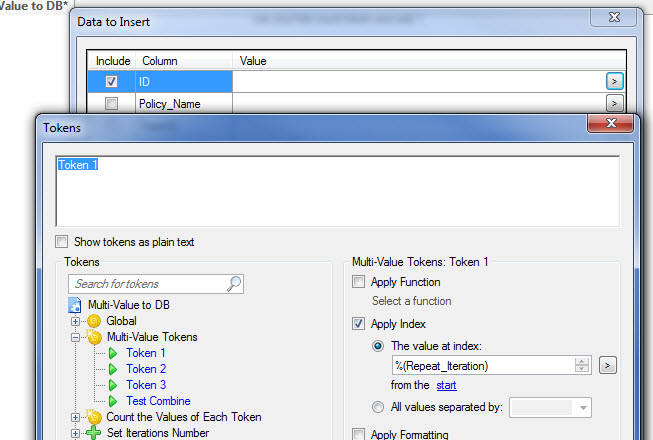

I can make it work if I put it in a Repeat instead of a For Each loop.  To test it I just combined them into tokens but the same principle will work for Insert Data.
When I put it in a Repeat I can use the Iteration number to tell it which value of the multi-value token to pull (i.e. iteration 1 pulls first value from start, iteration 2 pulls second value from start, etc.)

Show the section of your workflow that does the "For Each" so that we can see what you are doing.  Then we can help you correct anything that is causing the problem.  Also, have you used a Token Tracker to see if all the multi value tokens are the same length?
