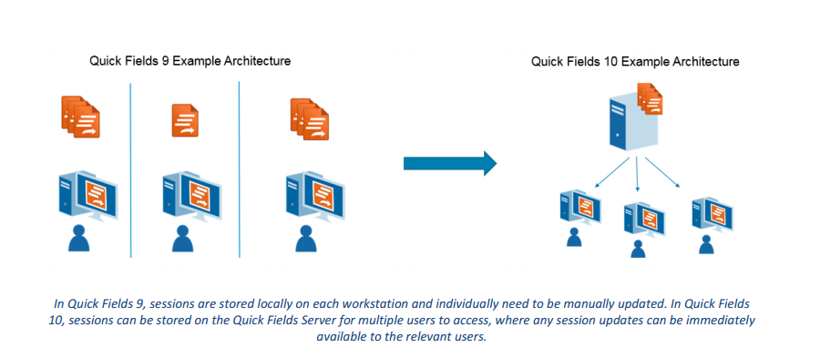

Yes, for the 1st question.
Regarding the 2nd one, In Quick Fields 10, sessions can be stored on the Quick Fields Server for multiple users to access, where any session updates can be immediately available to the relevant users.
QF sessions.PNG (88.02 KB)

While this is true for Quick Fields, it is incorrect for Quick Fields Agent. Quick Fields Agent does not use sessions from the Quick Fields Server at this time, it only works with locally saved sessions files.
