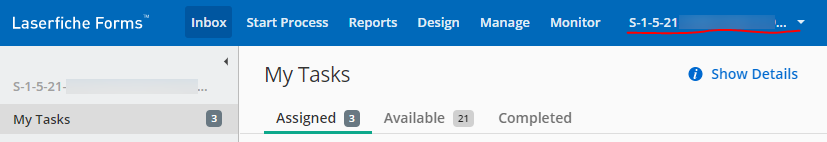

I'm having what sounds to be like a similar issue, except in Laserfiche Forms. Users are unable to log in unless they include the domain. When they do, their SID shows in the top right corner rather than their display name. On top of that, internal applications fail when this happens because LF Forms cannot find any users. A temporary solution is to go to Forms Config > User Authentication and re-enter and saving the config, but that isn't a sure-fire solution most times. This is happening on an irregular basis every 1-4 weeks since I installed version 10. I am currently on version 10.2.

Are you using Single Sign On for Forms? If not, this is not coming from Directory Server and you should probably either start a new thread or open a support case.
If you are using Directory Server for managing your Forms users, are the users displayed correctly there?
replied on August 15, 2017
No, I'm not using single-sign on as it wasn't accepting the "license site display name" when I initially tried to configure it. That's a separate issue as well.
Yes, Directory Server does show the correct display name rather than the SID.
