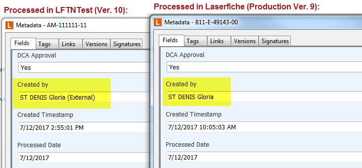

This is how my Display Name has shown in Outlook since November 2016:
I processed two records today ... one in the test system (Forms Ver. 10) and one in production (Forms Ver. 9). Turns out, the "display name" grabbed from Ver. 10 vs. Ver. 9 is different!
So, now I have to accommodate the number of characters in this field to support the extraneous info being brought in.

Actually that's a known and expected change. Before Forms 10.0, Forms uses Name attribute in AD for display name for Windows user; since 10.0, we changed to use Display Name attribute to be consistent with LFDS and Workflow.
Sorry for the inconvenience.
