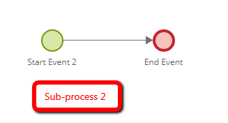

replied on July 10, 2017
Yeah the issue was found on 10.2.0 update 1 as well, and it's related with sub-process. It does not quite like what you described but the error log looks similiar. The process with issue is like this and error occurred on Inclusive Gateway (3):
If you would like to try 10.2.1 update 1, the package downloaded from support site should already contain the update 1 fix (there is a update folder inside), so you just need to install that one.
