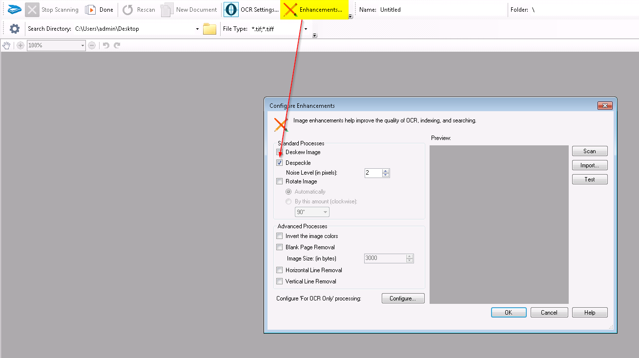

Have you tried applying the "Despeckle" image enhancement? See the screenshot below for details.

replied on July 6, 2017
Yes, I did. It does remove the speckles but  also removes the periods in the text.
Have you tried adjusting the "Noise Level" to see if that improves the results?
