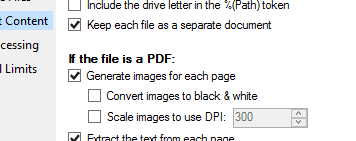

I have a Quick Fields session that does not need to identify documents as each PDF we are processing  is it's own document. To do this i use the 'Keep each file as a separate document' option in the universal capture configuration window.

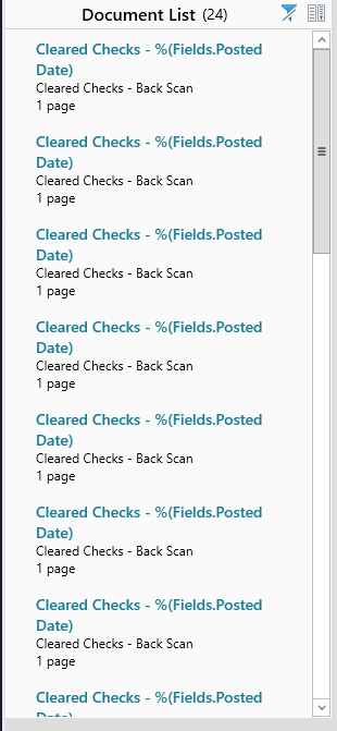

When running the session in Quick Fields everything operates fine. When running the same session in Quick Fields Scanning each page of the document is split into separate documents.   I have run into this a couple of times now and looking for any input on how to get the Quick Fields Scanning app to operate the session as designed.

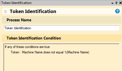

As a workaround, I was able to get the desired behavior in Quick Fields Scanning by adding a condition to Last Page Identification that will never be true, and then re-publishing the session. For example, I used:

The 'Keep each file as a separate document' option is meant to ensure that the document is ended when the end of a file is reached, but it's not necessarily going to prevent other settings in First or Last Page identification from ending the document before the end of the file is reached.
It's hard to determine what is causing the discrepancy without more information. What do your First Page Identification and Last Page Identification settings look like?

There are no processes in the first page identification at all. This is what it looks like when processing in QF (1 PDF)
Here is the same process, session, classification, and document in QF Scanning

replied on July 7, 2017
The work around works in both Quick Fields and Quick Fields Scanning. Thank you!
