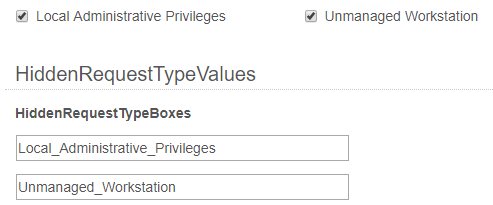

Hello,
I'm working on a form that takes values from 2 checkboxes. These checkboxes belong to the same question; kind of a "Check all that apply" format. So, since you can check the 2 checkboxes, when the values are saved in the Repository-->Field, the values are separated by a comma (see screenshot below).
I was wondering if they can be grouped into individual Fields, one below the other, without the use of Workflow.
Would it be better in this case to add the question responses separately, and just differentiate them by a Yes/No value?
What do you think?

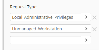

replied on June 27, 2017 • Show version history
Jason, that's exactly what I was looking for. I created the table with two fixed fields and used Javascript to pass the value for each checkbox. Then I had to go back to the Template and check the checkbox for "Multiple", which I hadn't done. Tried it and it worked. Then I was wondering if it would work without the Table, and only the "Multiple" checkbox on the Template checked, and you are right, it did not work. So that would be a good feature request.
I guess with a little more JavaScript I can remove the unwanted underscores too.
Thanks again Jason, that did the trick.
