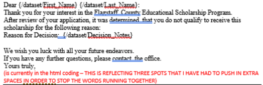

THE FOLLOWING IS (1) THE CODING CURRENTLY IN THE ACTIVITY, (2) COPIED FROM AN EMAIL SHOWING THREE WORD GROUPINGS RUNNING TOGETHER, (3) COPIED FROM AN EMAIL AFTER ADDING ADDITIONAL SPACES BETWEEN THOSE WORDS IN THE EMAIL ACTIVITY IN THE FORMS PROCESS DIAGRAM:
Dear {/dataset/First_Name} {/dataset/Last_Name}:
Thank you for your interest in the Flagstaff  County Educational Scholarship Program.
After review of your application, it was determined  that you do not qualify to receive this scholarship for the following reason:
Reason for Decision:  {/dataset/Decision_Notes}
We wish you luck with all your future endeavors.
If you have any further questions, please contact  the office.
Yours truly,
(is currently in the html coding – THIS IS REFLECTING THREE SPOTS THAT I HAVE HAD TO PUSH IN EXTRA SPACES IN ORDER TO STOP THE WORDS RUNNING TOGETHER)

replied on June 26, 2017
In Word, you can see where the extra spaces are more easily:

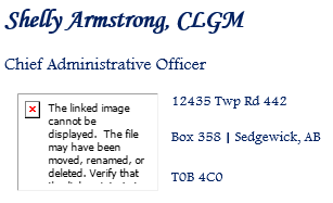

The CAO's signature formatting also is effected by some spacing issues.  Again, this was brought in using a cut and paste action.  Would like to somehow be able to have her signature show up the way we want it in LF emails, but not sure what can be done about that.

Rui, I have discovered that if I do not cut and paste the wording into the email activity, I get better results (see another reply done today above this post) however, the CAO's signature formatting is still a cut and paste.  Not sure if you can help me with that part.
Below is the clip I did cut and paste into the email activity, plus the html section of this (which I did alter by removing the sections for the website address, email address and phone numbers, trying to minimize the impact of the additional spaces pushed in by the LF forms email activity), plus a copy of the final result in the actual email sent by LF forms email activity.

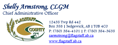

Hi Connie,
For the image, you need to first save the image, place it in Forms install folder/img, so the image is hosted in Forms website and can be accessed with link like http://formsURL/Forms/img/clip_image001.jpg.
Then, add this to the HTML tab of email service task:
<img src="http://formsURL/Forms/img/clip_image001.jpg">
replied on August 25, 2017
Rui, thanks so much!  With the help of my IT staff today, we got this signature image working perfectly in the emails using your instructions on how to get the image in the email service task.
