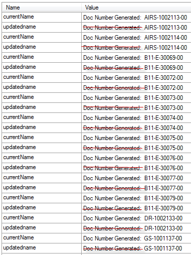

This is what I want my end result to be:
I've created a "currentName" token and would like to take that, remove "Doc Number Generated:  " and remove it to create an "updatedname" token. Here's the info on the tokens:
As you can see from the first image, it's not removing the words I want removed. What am I missing????

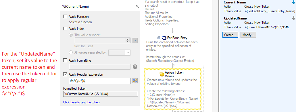

For your updatedName token, try using this value
%(currentName#<Doc Number Generated:\s+(.+)>#)
replied on June 23, 2017
Thanks! That worked.
And, OF COURSE, yours worked too, Bert! Thanks for bailing me out again. You've become such a useful resource for me! I truly appreciate the time you take to provide me with so much detail!
