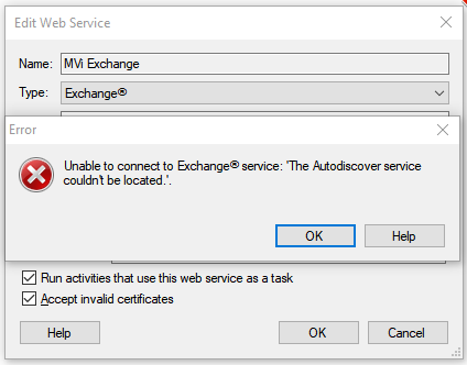

We are trying to setup the Exchange Web Service to connect to our 2016 Exchange server.
The URL we are using is https://mail.domain.com/ews/exchange.asmx
When I test it with my credentials I get the following:

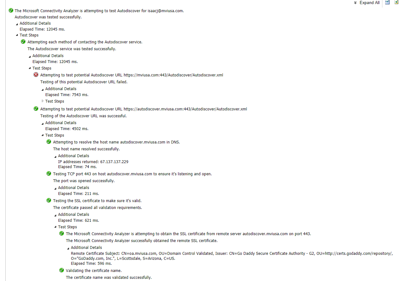

However, if I test my EWS at  https://testconnectivity.microsoft.com/ the only error I get about autodiscover is the following:
Attempting to test potential Autodiscover URL https://mviusa.com:443/Autodiscover/Autodiscover.xml
 Testing of this potential Autodiscover URL failed.
Additional Details
Elapsed Time: 6066 ms.
That URL should fail since that is pointing to our webhost / website and not our internally hosted Exchange server.  Autodiscover seems to work with our Outlook clients, so not sure what I may need to have our Exchange admin look at.
We have also tried using the local DNS name for that server as well as the FQDN for that server.  We have tried the following paths with both the Public URL, Internal Friendly Name as well as the FQDN.
  • /ews/Exchange.asmx
  • /ews/UM2007Legacy.asmx
  • /Autodiscover/Autodiscover.xml
Both of the EWS links give the error about finding auto discover whereas the Autodiscover link just times out.

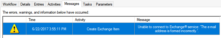

Using the ews urls above we tried to change the Type in the Edit Web Service dialog box from Exchange to Custom.  If we leave the User Name as username @domain.com we get 401 unauthorized.  However, if we change the login name to Domain\Username the connection tests successfully.  The issue there is when the workflow runs we get the following error.
I am sure we are missing something simple.  Any help would be appreciated.

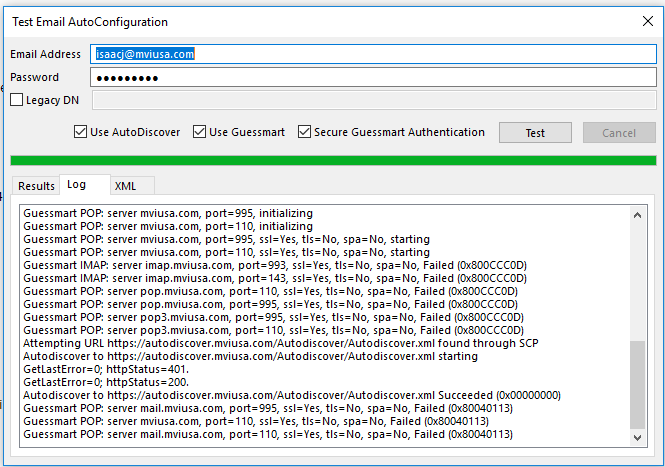

Sadly no, this is the response I received from Laserfiche Presales.
Can you confirm that the Autodiscover service is configured correctly on your Exchange server? Please refer to this article (or this article) for more information on how to configure exchange services. Since you are receiving an error when using the test utility (https://testconnectivity.microsoft.com/), it seems like you may be experiencing a security issue within Exchange. Once you are able to successfully connect to Microsoft’s test utility, we can further investigate this issue.
I have attached our test results from our exchange administrator.

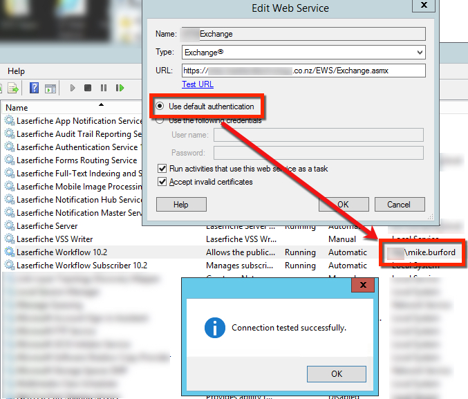

replied on July 10, 2017
Hi Jason,
I've been testing based on the same response from LF Support and seem to have found a workaround, although we're on Exchange 2013 so I'm not sure if it will work with 2016.  The issue was with the UPN format and I couldn't get consistently successful tests using my email address as username - it would work sometimes, but more often would fail.  However, domain\username format worked every time.  So I used my account as the "Log On As" account for the Laserfiche Workflow Service, and set the Web Service to "Use default authentication" and it tested/connected successfully.  I'm talking with our server admins and will look at using a service account with an Exchange mailbox as the Log On account for the Workflow service as that seems to be the fix.
Hopefully this is helpful in your case.
Cheers,
Mike

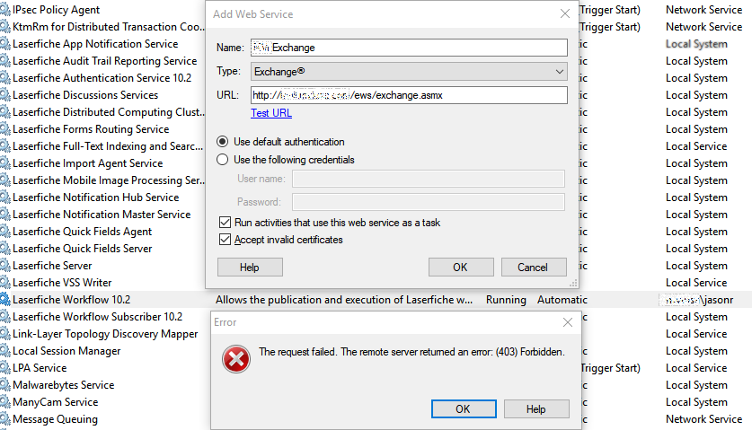

So here is my setup.  Only difference is Exchange 2016.  I am doing everything with my user, and my users calendar so I should have full rights.  But now using this setup I am getting 403 forbidden.
nd.
Try with HTTPS, does that make a difference?

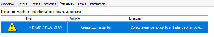

replied on July 11, 2017
It allowed the connection to test successfully.  Then when the workflow ran, I got a warning for the Create Exchange Item step.

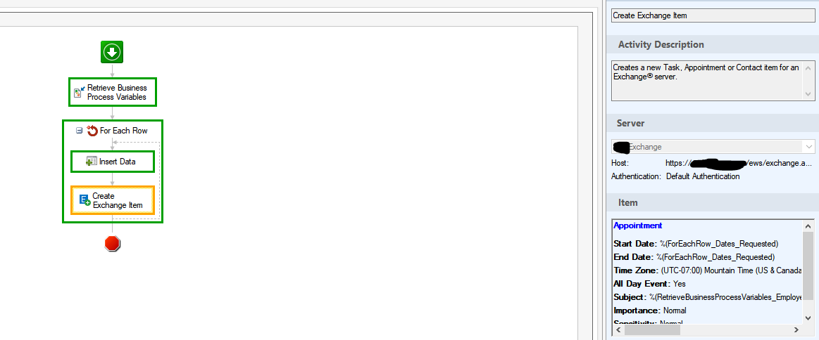

You don't have a For Each token on the Subject field, though I don't know if that would be the issue.  It would be worth testing by manually entering each field entry in your Create Exchange activity i.e. type in the dates, subject, etc. to check that it's not a token issue or similar.
replied on July 12, 2017
So when I went with Static values it worked.  Doing that, I think I found the last issue.  My dates didn't have times with them.  So once I put all my tokens back in, and this time put a time with the dates.  It worked!  Thanks for the assistance!
