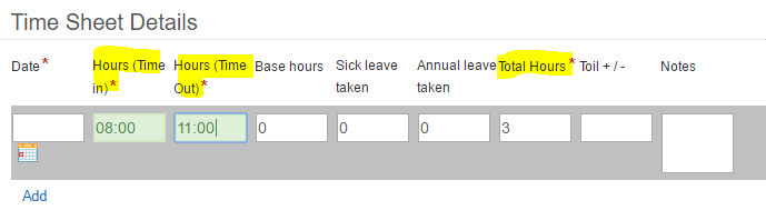

We have a Form that is used for Timesheets. At the moment based on "Hours In" and "Hours Out" per Table line, we are using JavaScript to Calculate the "Total Hours"
What I would like to do now is:
Based on the "Total", I want the end user to specify if the hours worked were either "Base Hours" Or/and "Sick Leave Taken" Or/and "Annual Leave Taken"
The total of the Three inputs requires to equal "Total Hours" calculated earlier from Javascript.

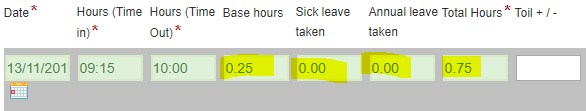

If the user has worked 0.75 hours and you enter in 0.25 in one of the fields, and enter 0.0 in the others, it does not advise you that it is incorrect? and the validation is ok?
As per below:

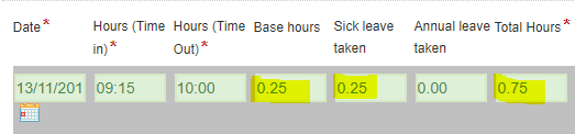

But, if i am to then change the numbers and add another 0.25 it is still accepting it as valid?
Only if i go over the value, it advises that it is incorrect, but not when it is under the value?

I used parseInt function in the original script so it would ignore value less than 1.
Can you change all the parseInt to parseFloat and see if it works as expected?
replied on November 13, 2017
Hi Rui,
That worked perfectly, thank you so much for the prompt response as well,
