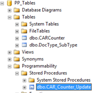

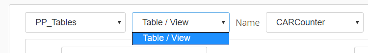

So problem 1. I made a SP but it doesn't show up in the lookup rules dropdown for the table... what am I doing wrong?
2. I don't know if I have my SP correct or not. I'm not a SQL guru but I can muddle my way through if I know what I'm looking at (reverse engineer here). This is the code I'm trying to use, and it's probably wrong :).

1. Did you refresh the data source after adding the stored procedure?

So we figured it out what was wrong with the stored procedure. It was the permissions were wrong. They didn't give LF access was why it wasn't showing up.
