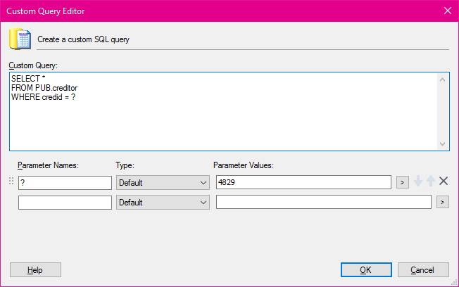

I have created an ODBC connection to a Progress DB using OpenEdge 11.
I got a username “guest’ to use as log in.
Following all the steps provide by my client the ODBC connection works 100%
When using Laserfiche WF to query data, I get an error. Using Custom query in wf I do get data back from the look up, but it is all the data in db.
When using Forms to connect to the ODBC, I get the following error.
[LFF502-UnexpectedError] Inner exception: System.Data.Odbc.OdbcException Message: ERROR [42S02] [DataDirect][ODBC Progress OpenEdge Wire Protocol driver][OPENEDGE]Table/view/synonynm "GUEST.CREDITOR"
So, when creating the ODBC connection using the username guest, it also creates a Schema called GUEST. Using this I do not get any data back using Laserfiche Forms or the Query data in WF
The Schema must be PUB (as per screenshot)
The other problem that I am facing is that the table columns name is created with hyphens in ( cr-number) for example.
How will I use these in the custom query in wf? I have tried to use square brackets ([]) to specify a column but no luck

This is a driver error, not a Laserfiche error, so we're not going to be able to provide much help.
The error message you got in Forms seems to be truncated so it's hard to say what's going on. Based on the error code, the Progress documentation indicates it's expected behavior and you should be using double quotes not brackets.
For the Guest/Pub schemas, you'll probably have to create a synonym in Guest's schema to point to Pub's table.

replied on June 22, 2017
Hello Miruna
The complete error when i use the odbc via forms is as follows:
HTTP Status Code: 500
Business Process ID: 0
User: LFForms
IP: ::1
Browser: Mozilla/5.0 (Windows NT 10.0; Win64; x64) AppleWebKit/537.36 (KHTML, like Gecko) Chrome/59.0.3071.86 Safari/537.36
Business Process Name:
Stack Trace:
Caught exception: Laserfiche.Forms.CommonUtils.Exceptions.LFFormsException
Message: An unexpected error has occurred. [LFF502-UnexpectedError]
Message: ERROR [42S02] [DataDirect][ODBC Progress OpenEdge Wire Protocol driver][OPENEDGE]Table/view/synonynm "GUEST.REMOVALS" cannot be found. (15814)
   at System.Data.Odbc.OdbcConnection.HandleError(OdbcHandle hrHandle, RetCode retcode)
   at System.Data.Odbc.OdbcCommand.ExecuteReaderObject(CommandBehavior behavior, String method, Boolean needReader, Object[] methodArguments, SQL_API odbcApiMethod)
   at System.Data.Odbc.OdbcCommand.ExecuteReaderObject(CommandBehavior behavior, String method, Boolean needReader)
   at System.Data.Odbc.OdbcCommand.ExecuteReader(CommandBehavior behavior)
   at System.Data.Common.DbDataAdapter.FillInternal(DataSet dataset, DataTable[] datatables, Int32 startRecord, Int32 maxRecords, String srcTable, IDbCommand command, CommandBehavior behavior)
   at System.Data.Common.DbDataAdapter.Fill(DataSet dataSet, Int32 startRecord, Int32 maxRecords, String srcTable, IDbCommand command, CommandBehavior behavior)
   at System.Data.Common.DbDataAdapter.Fill(DataSet dataSet)
   at Laserfiche.Forms.EntityModels.Data.ODBCDBConnector.GetDataSet(String cmdTxt, ICollection`1 parameters, OdbcConnection connection)
   at Laserfiche.Forms.EntityModels.Data.ODBCDBConnector.GetTable(String cmdTxt, ICollection`1 parameters)
   at Laserfiche.Forms.CommonUtils.LookupServiceProvider.InternalGetLookupResult(Expression`1 ruleCondition, Dictionary`2 lookups, IEntityContext context, String LogonUserName)
I used the double quotes now and I am able to retrieve data from the DB
I have asked if they can create me a view so i can use forms to do the look up
Thank you again for the information
