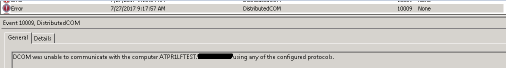

We are also receiving a similar error. We had an old Laserfiche server which was used for testing. The server is turned offline, but we are getting a constant DistributedCOM error in the System logs. I don't know if it is the same issue as above. See screenshot below.
replied on July 27, 2017
Hi Zach,
Since the old LF server is offline, your Forms server is now using new LF server right? Have you tried restart routing service after changing LF server?
replied on August 1, 2017
Hi Rui,
The old Laserfiche test server did not have Forms installed. Forms is currently installed on a different production web server. We can restart the Forms routing service on the production web server if you are confident it may still have an impact on our production Laserfiche server.
Thank You
I meant the Laserfiche server used on Forms server, not where the Forms is installed.
Can you check the Forms config site and see if the repository is still using the old LF server? If so, routing service would try to connect to the old server and that would cause trouble.
