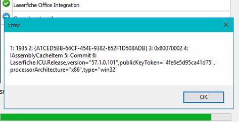

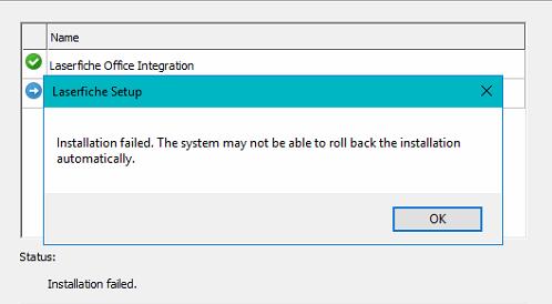

I am getting this error with installing the Web Access Extension with Chrome on multiple client computers.
I have completely removed Laserfiche Client from the computer and removed the older extension and verified no older registry values remained and a fresh install of this failed in the same way.
Was curious if anyone has been seeing this and has a solution.
Thanks!
replied on June 20, 2017
Hi Chase,
Please try to reboot your client machine, we met the similar issue when there is a windows update that requires system restart.
replied on June 26, 2017
Attempted multiple computer restarts with checking if there are any windows updates.  Still the issue persists.
Hi Chase,
Please install Microsoft Visual C++ 2015 Redistributable, which can be found in the support folder of install package.
