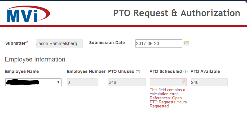

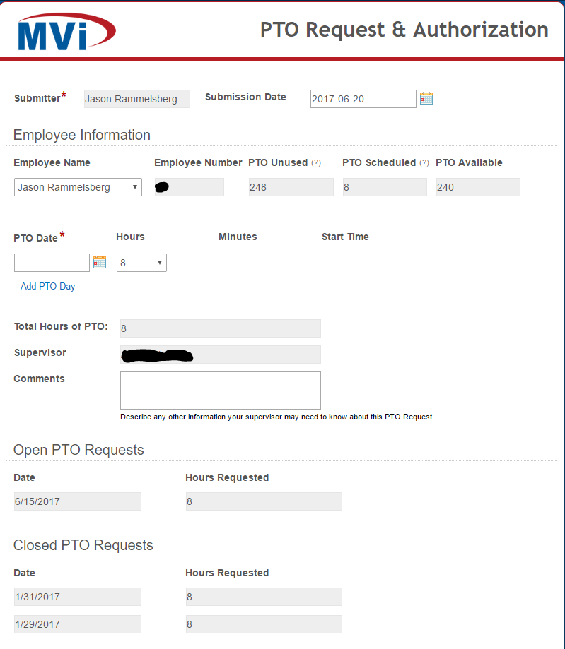

Thanks Steve,  sadly that formula does the same thing as the formula I was using.  If there is data in the table called Open PTO Requests (See first image) then it puts the total number of hours from all the lines into PTO Scheduled box.  If there is no data it leaves the PTO Scheduled box blank rather than putting in a 0.  It needs to be a 0 so I don't get a calculation error (second image).  Once that info is populated, the final number for PTO Available is calculated by subtracting the PTO Scheduled from PTO Unused so that the employee knows how much PTO they have left for the year after they take what is already scheduled.  This formula works great to calculate that AND will put in the 0 when the PTO Scheduled is blank.

I really don't need a zero in PTO Scheduled as much as I need it to ignore the calculation error when submitting the form.  However, I would like to get the calculation error fixed :).

I have tried that as well.  But the formula seems to override that 0.  As soon as the preview loads the field is blank.  If the lookup finds data it fills the field.  If I change the person's name to someone where there are no PTO days for lookup, the field just stays blank.
