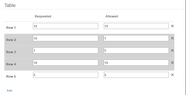

Good day all.
I have a form that changes the row color based on values entered. If either value entered is larger than the other value entered, the row color changes. The problem is that the color does not show in the next approval step. it only shows when the user submits the form. The color also does not appear on the form when it is saved to the repository.
here is the code :
setTimeout(function(){
$('body').addClass('loaded');
}, 3000);
$('.cf-table-block').on('blur', 'input', highlight);
function highlight(){
    $('.cf-table-block tbody tr').each(function(){
			var t1 = 0;
			var t2 = 0;
			t1 = parseNumber($(this).find('.requested input').val());
			t2 = parseNumber($(this).find('.allowed input').val());
			if (t1 > t2) {
				$(this).closest('tr').css("background", "LightGrey");
			else if (t2 < t1){
			else if (t1 == t2)
				$(this).closest('tr').css("background", "none");
	 function parseNumber(n){
     var f = parseFloat(n);
     return isNaN(f) ? 0 : f;
Any help will be greatly appreciated.
replied on June 19, 2017 • Show version history
Hi Claudette,
In your script, the highlight function is triggered on "blur", which is an event sent to an element when it loses focus. On approval step, when value is populated on form load, the blur event is not triggered so the function is not triggered. On file save to repository, the form would be transformed to read-only form so there is no "input" element on form, and you won't get filled value with input.
To trigger color change on form load, call highlight() function directly inside document ready;
To trigger color change on read-only form, add the following when read t1/t2:
if ($('[name=IsLocked]').val() == 'True')
    t1 = parseNumber($(this).find('.requested .ro').text());
    t2 = parseNumber($(this).find('.allowed .ro').text());
Besides, the two branches "if (t1 > t2)", "else if (t2 < t1) " are the same, so as a result there is no color change for t1 < t2 on form load. I guess it should be "if (t1 != t2)"?

replied on June 25, 2017
The entire script would look like this (same for all forms):
}, 3000);
highlight();
			var t1 = 0;
			var t2 = 0;
			if (t1 > t2) {
			else if (t1 < t2){
			else if (t1 == t2)
