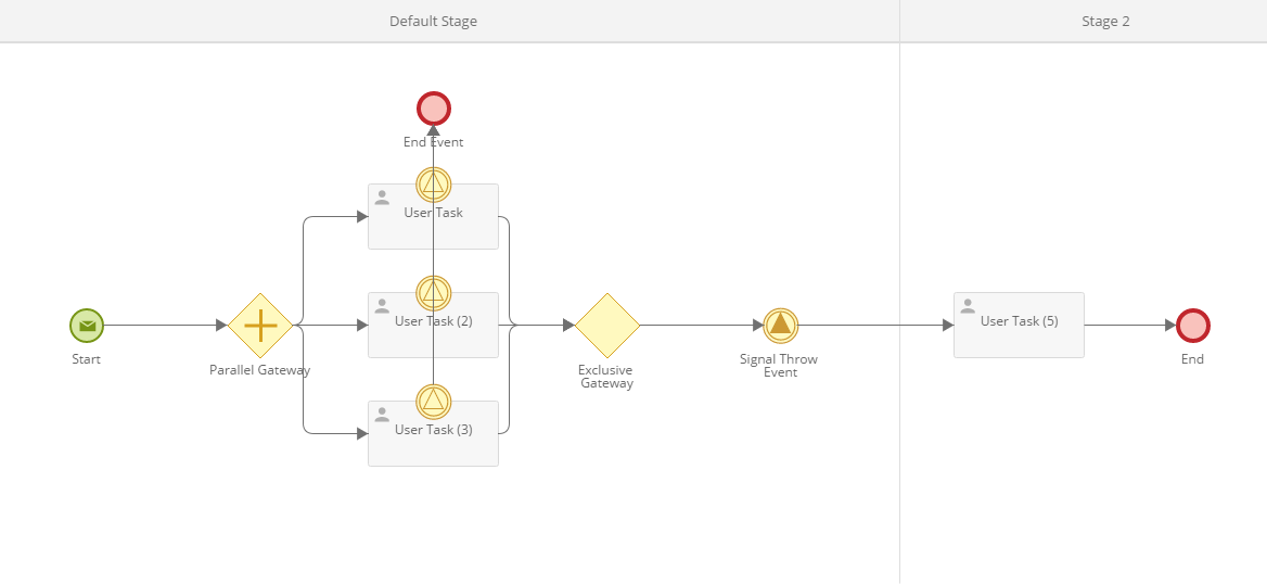

I have a similar parallel approval process and mine is working as expected. One difference with mine is that I merge the output of the parallel tasks to utilize a shared signal throw event that is triggered by whichever one is completed first.

Right, that is what happens in my process. If any 1 of the multiple parallel approvers approve or reject the form, it proceeds to the next step. The only tasks that are cancelled are the other parallel tasks that are no longer required.
For example,
  1. User submits a form
  2. Parallel asks are assigned to User 1, User 2 and User 3
  3. User 3 Approves/Rejects the form
  4. Signal throw is triggered - Tasks for User 1 and User 2 are cancelled
  5. Process continues to the next step(s)
If you attach a normal End Event to the signal catches, it should only stop that specific branch, not the entire process. The idea is that all branches have to lead to some kind of end event even if the user task is cancelled.

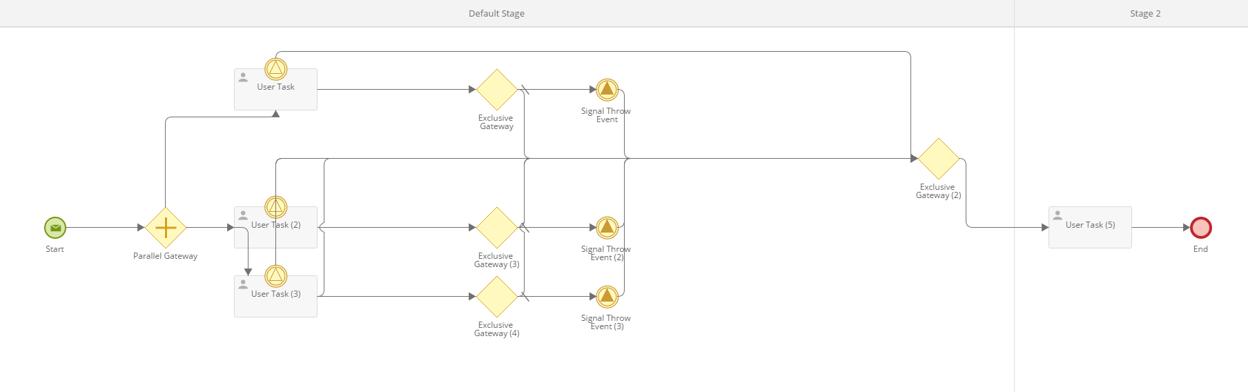

It sounds like you should have something more like this:
Out of curiosity, why do you have two branches coming out of those Exclusive Gateways? It seems like that would give it the option of bypassing the signal throw to allow all three processes to go through.
