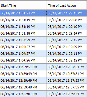

asked on June 14, 2017
All of the workflows for a particular server are showing that they started roughly 2 minutes after they completed and thus show a duration of 0ms.

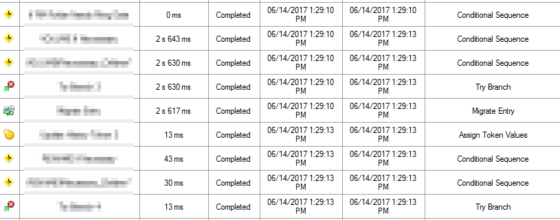

Additionally, if I go into the workflows they show the End Time being before the Start Time, show the duration in the bar graph wrong, but do show the activity duration correctly.
If I go to the activities they show the correct durations but seem to match up more with the End Time than the start time.
Oddly enough they have another server running workflow and it is functioning properly.  They are both running 10.0.0.249.  Has anyone seen this issue before?

Is the SQL Server on a different machine?
replied on June 15, 2017
It is on a different machine.
Sounds like the internal clock of one of them is drifting.
replied on June 20, 2017
So if I understand correctly, for the start time it pulls the time from one server and for the end time and activity times it pulls it from a different server (if SQL and Workflow are installed on different servers).  While I agree the servers should be syncing up with the correct time it seems odd that Workflow would pull it's times from two different locations while processing.
