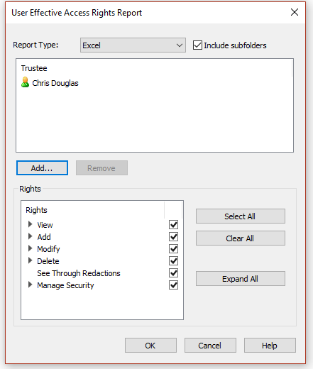

Hi Justin,
Hmmmmm, guess I'm missing something. Let me paint a picture, let's say I have 100 users setup as windows accounts in the repository, and I have a document in the repository, I want to run a report to see what rights those 100 users have on a particular document. How would I do this, as currently the only was I can see to achieve this is to manually add the 100 users at this point:-
Which obviously isn't ideal, and also you can only add them one by one (shift selection doesn't work).

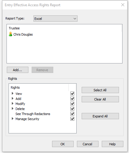

replied on May 21, 2019
You want the Entry Effective Access Rights Report, not the User one. The User one is to give you 1 user and show all the entries, the Entry is to give you 1 entry and show all the users.
replied on May 22, 2019
Hi Justin,
Ok tried the entry effective access rights report, but this still only displays the users I select in the report, so back in the same boat.

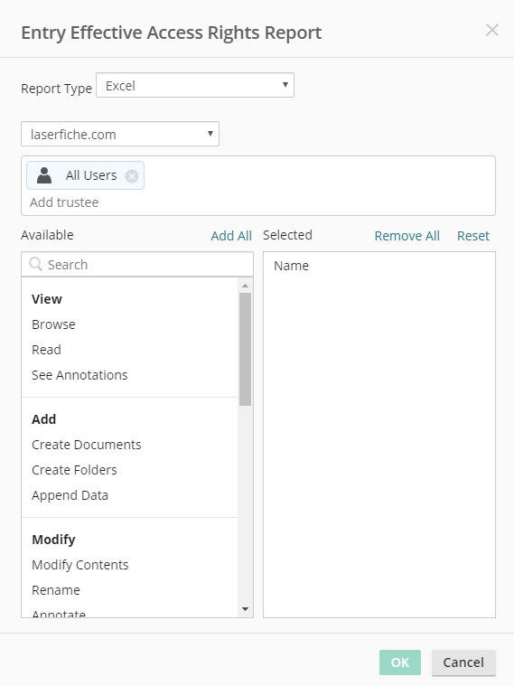

Have you tried selecting either 'all users' or the Everyone group? You should be able to select groups:
replied on May 23, 2019
Ahhhh you're using the web client. Yes works for me fine too there, in the thick client there is no option to select all users or the everyone group, which is where I'm seeing the issue.
Oh, interesting. I didn't realize that was a difference between the two of them, I admit I've never personally used the windows client version of this report generator. Well, there you go!
