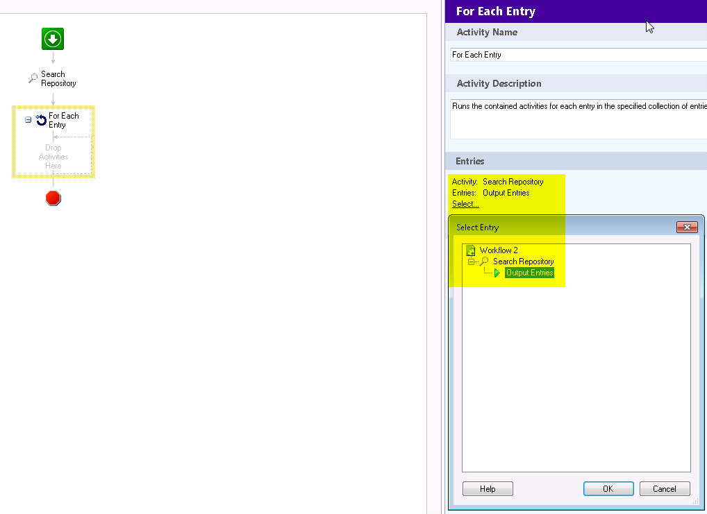

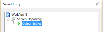

My first thought is that your "For Each Entry" activity is pointed at the "Starting Entry" or isn't specified. Is your "For Each Entry" activity setup like this:
Confirm that it is pointed at the entries returned from the "Search Repository" activity.
replied on June 14, 2017
This is what the For Each Entry is pointing at - there are no other options:

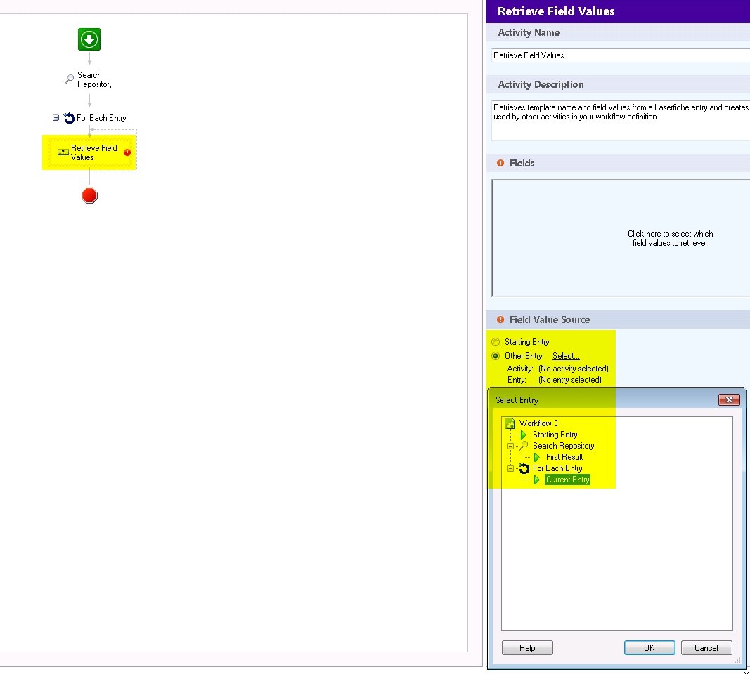

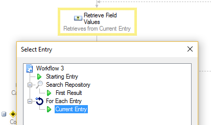

My next question is, is your "Retrieve Field Values" activity pointing to the "Current Entry" of the "For Each Entry" activity?
It's pointing to For Each Entry-Current Entry:

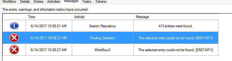

I updated the Retrieve Field Values to remove a couple, and now I don't receive the error, but instead get another error on the Routing Decision activity"
I'm guessing that before you didn't have the Retrieve Field Values activity published with the correct entry selection.
Now, it seems that your Routing Decision activity is referencing the starting entry in one of its conditions rather than the current entry from For Each Entry. Can you attach a screenshot of the conditions?

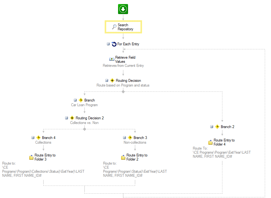

I also updated the Retrieve Field Values to reference the Current Entry from the For Each Entry activity before I ran the updated version. Below is the current setup:
The conditions in Branch and Branch 4 still reference the starting entry.
