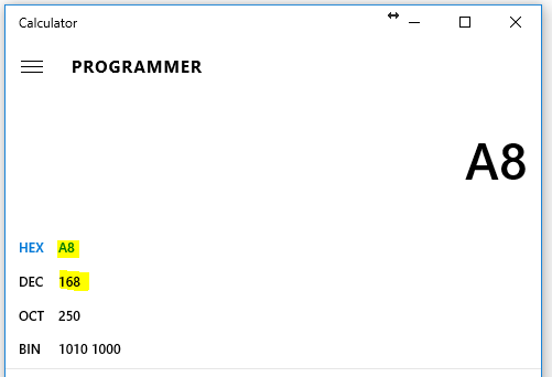

Replace the Y with the decimal equivalent of the Hex document name.  Use a Programmer calculator in Hex mode to enter the Hex (without leading zeros) to get the decimal conversion.

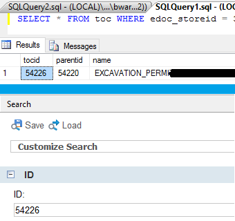

If you have access to SQL, you should be able to search the "toc" table for a "edoc_storeid" of 866 (comes from converting 362 hexadecimal into decimal). You may also want to include the volume in your search. You would have to find the volume ID of the relevant volume from the "vol" table. Altogether, your query would be something like:
SELECT * FROM toc WHERE edoc_storeid = 866 AND vol_id=X
That would give you the entry name (if the entry exists in your system). Easiest thing to do would be search your entire repository for that entry name to find the document in question. You could also figure out the path in SQL if you prefer. Each entry also has a tocid and a parentid. A parentid is just a reference to another tocid in the toc table, which would be the parent folder of the current entry. You can use this to track the folder structure back to the root level.

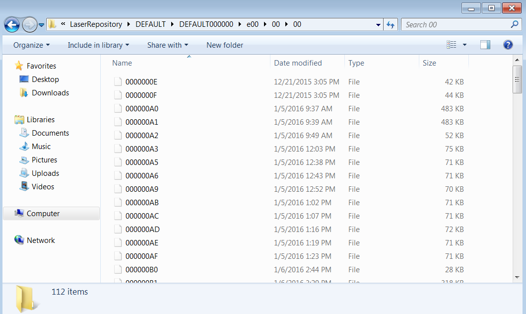

If you have access to the volumes, you could always locate the file by following the directory path.  I don't think there is advance search syntax that would allow you to do it from in Laserfiche client.
