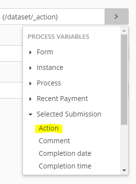

When setting up the "Save To Repository" task, you should be able to add the user action into the folder path, document name, etc.
However, it would match whatever the action is called so you might get "Approve" or "Reject" instead of "Approved" or "Rejected" depending on how you label the buttons.

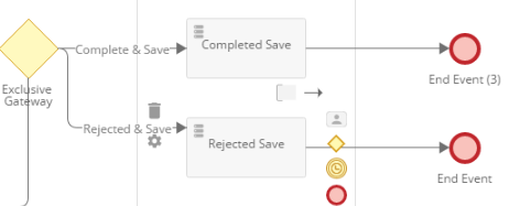

OR you could create a decision branch (exclusive gateway) in the business process, with two different "Save to Repository" tasks: one with Rejected in the name, and the other with Approved. Then, use the "Last User Action" value in the Path Conditions (outflows) for determining which one to use.

Oh my gosh that was it. I didn't realize action was tied to the actual name on that action. I had branched the process already anticipating it would be the right thing, but just couldn't get the name to go on right.
Sometimes the problems that give me the most grief are the simplest to answer. Thank you so much!
