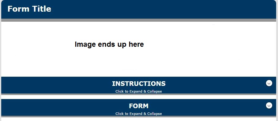

I  am currently trying to create a custom header for a form using JavaScript. Unfortunately so far
 I haven't had much luck, my attempts have only had the logo appearing underneath the form title (shown in attached image).
Would anyone happen to have any thoughts on how to get the logo to appear above the form title field?
the script i was using is as follows (i have since removed the image location i was using) :
 $('<head><img src="[insert image location here]" style="margin-left: auto;margin-right: auto;display: block;width;100%;"></head>').insertBefore($('.cf-form'));
To be honest i'm still learning some of what JavaScript can do, as such the script above is me trying to  re-purpose a line of script that a colleague used for footnotes, into one for headers frown apologies if I've butchered it!
Many Thanks,
Chris

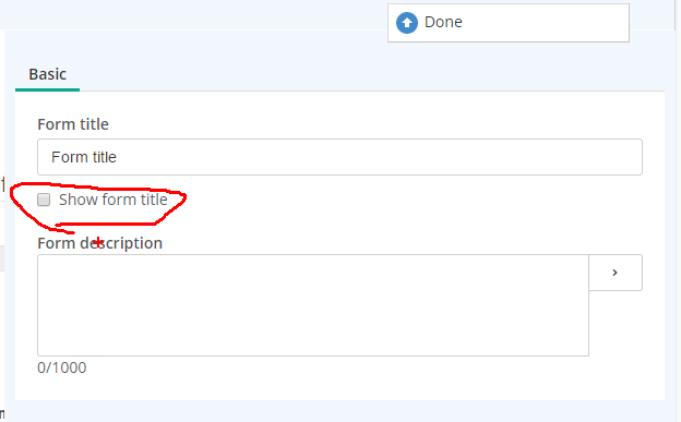

I'm sure there are many ways of doing this.
One way that I can think of would be to use the built-in setting to hide the title all together. Then you could use the Custom HTML field to make your own.
