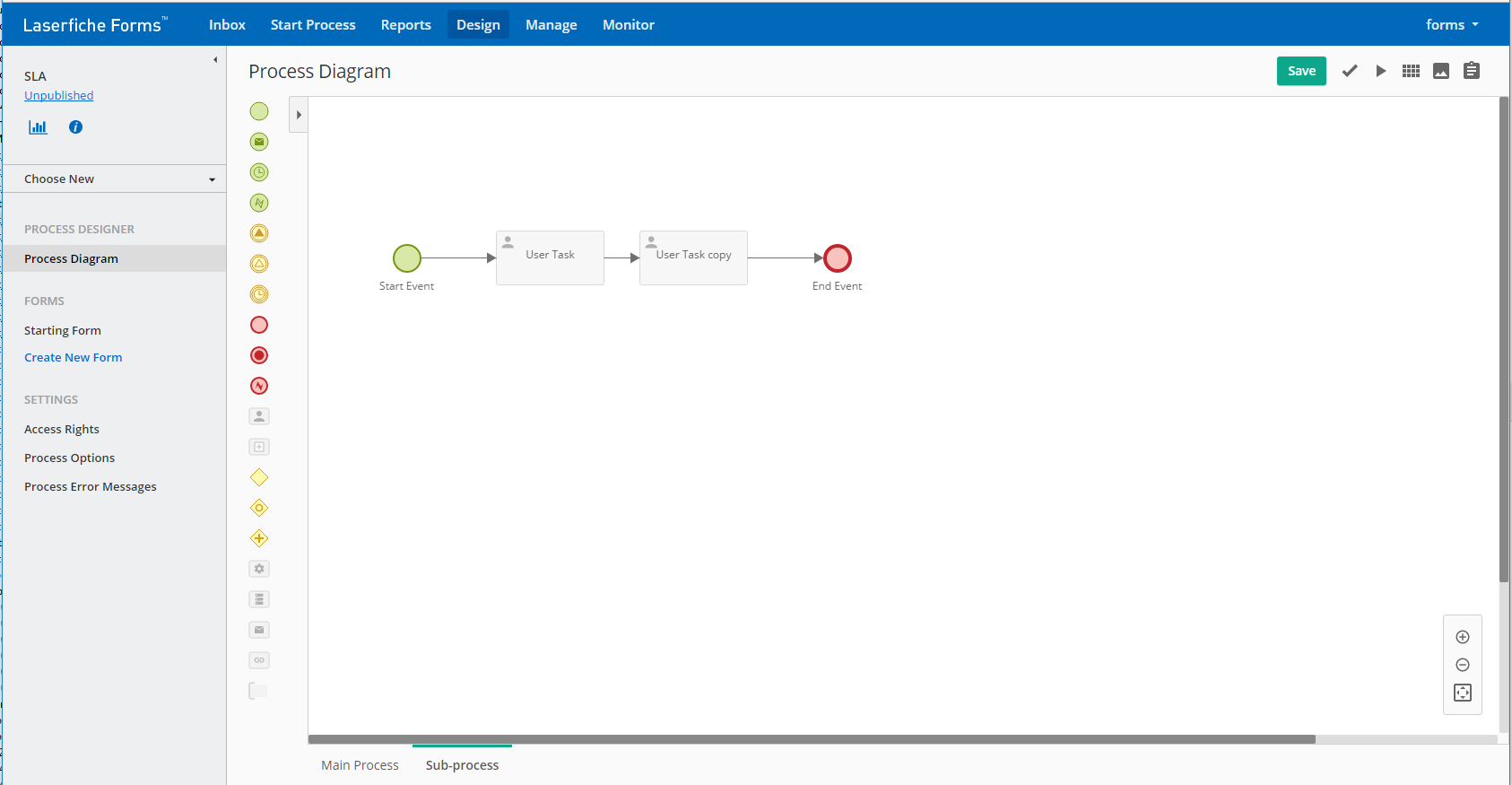

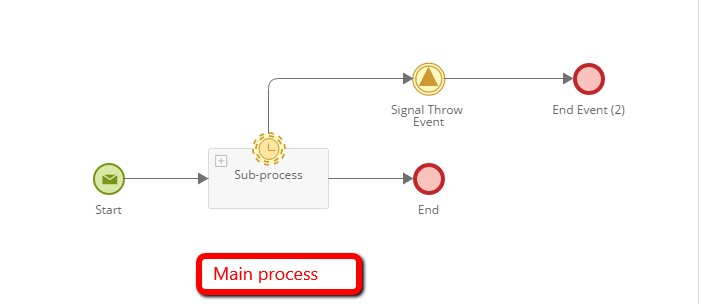

Maybe you can use signal events to achieve this. Add a throw signal event after timer boundary and add signal catch event in the sub process.
It is not a good idea, but I don't have a better one
