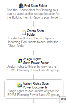

I don't know how many folder templates you have but could you recreate each template in a workflow and then have your original workflow with the copy folder step just invoke the workflow for the correct template?  This is how I build all my folder structures so when I move the process solution between my Dev, Test, and Production environments I don't have to reset permissions on the folders each step.  I just promote the workflow to each environment and run the workflow to create the needed folder structure and set permissions.
replied on May 26, 2017
Thanks Jennifer, we were preparing to use workflow to create all those explicit permissions if there's no way to copy them in workflow. I had just hoped we could do it with a copy, since the folder tree we're copying has a bunch of explicit permissions and makes for a large workflow to set all those permissions.
