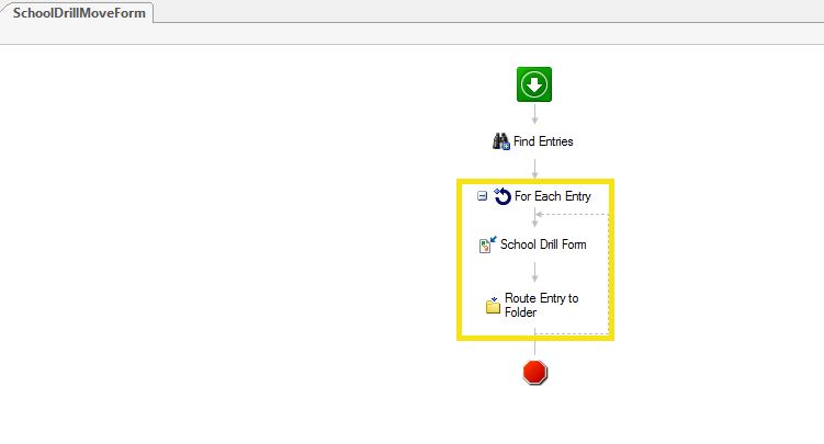

It doesn't seem I can do this so I was looking into a workflow  that uses "Retrieve laserfiche forms content" and then route to folder based on the information pulled from there (Name and Date). Attached image.
I am getting an error message that says "This workflow does not appear to be started by forms. The forms instance id was not specified or was empty"

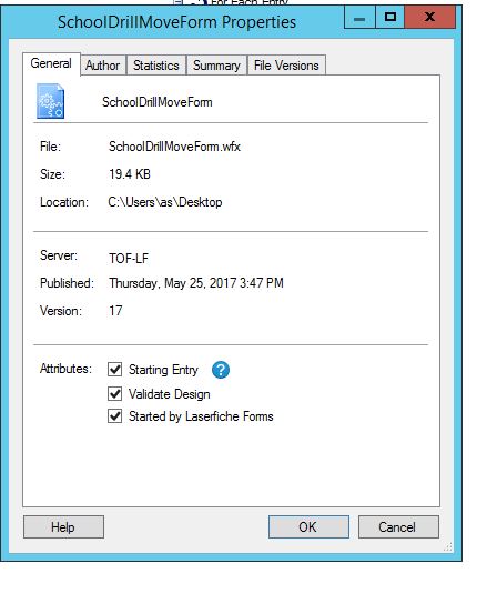

Is your Workflow called by the Form process ?
If so check, the advanced properties of the "Retrieve business process variables" to see if the Instance and the submission ID are the one from the form who started the Workflow.
If you want to start the workflow with a starting rule or something, you'll have to provide the Instance and Submission id of the submitted form with a token (In the name of document by a pattern matching or a metadata).

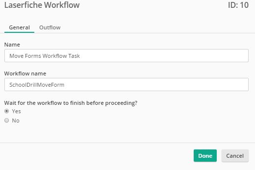

So are you suggesting I should have the form  service task  place the form in the repository and then have another  service task call the workflow?

You could run the Workflow every X minutes/hours but the "Retrieve business process variable" has to know from wich form submission it has to take the info from.
In the name or metada of the form you save in the repository, you could add the instance id and the submission id so you could give the info to the "Retrieve bussiness process variable".
Or you could call the Workflow with the form process each time a form is submitted, right after the form saved the document in the repository, so the form submission is able to give the Workflow the instance and submission IDs.

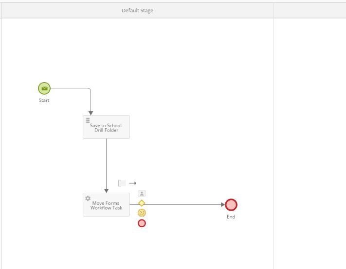

I have the workflow created(image attached). I think I have it mostly configured but wondering if I am missing something because after filling out the form it doesn't seem to create the folder based on what was chosen from the dropdown.

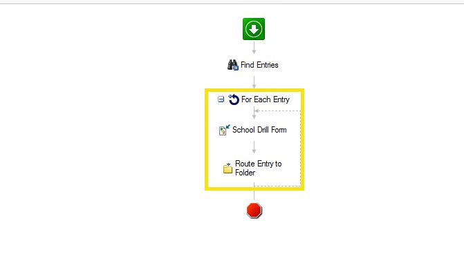

As far as i understand your process, the Workflow move only one document at a time (the saved form itself), si I don't think you would need a "For each entry" loop, but that's not probably the problem for the document not moving a the right plage.

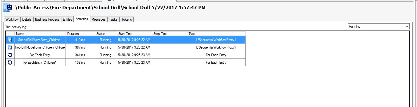

Have you checked the Workflow log to see if there was any error while this Workflow was running ?
Is the document moved at the wrong place or not moved at all ?
If you could post screenshots of the activities properties, maybe there is a little mistake somewhere.
replied on May 30, 2017
The documents don't move and the sub folders do not get created. I have tried a few times creating and submitting the form but they just get placed in the top folder.
