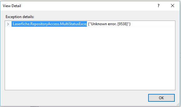

     I am working on creating a Solution for a client to integrate an AS400 system with Laserfiche. We have about 90% of the functionality working, by creating web services that the 400 can call to process data. I am stuck at the point of trying to update a multivalue field that is a part of a group. I use my existing logic and I get a Laserfiche.RepositoryAccess.MultiStatusException "Unknown Error [9538]". I will post my code and see if anyone has any suggestions.

If I check the debugger the FieldValueCollection has the correct information and it errors on the ei.Save(); Method. If anyone has any suggestions I would greatly appreciate it.
replied on May 25, 2017
Error 9538, in this case, means roughly "you're using an older version of the SDK to talk to the server and it can't be sure that it can make your changes to the fields without clobbering the field group relationships."
I'd try updating to RepositoryAccess 10.2 and see if that fixes it.
Thank you my good friend, this fixed the issue. Is there any code that you could share that works with metadata groups and group numbers? I am using an index identifier to select the row I want to update. I don't see any sample code available. Thanks for your input!
