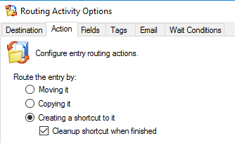

Or if you use the Routing activity, you can use the cleanup option to remove the shortcut when the wait condition is met.

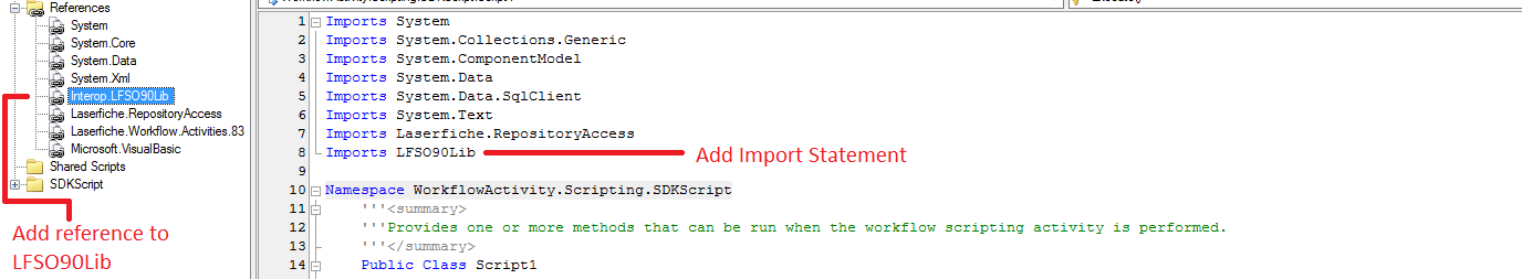

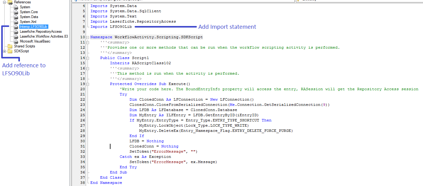

The only way I found to delete the shortcut was through LFSO
        Protected Overrides Sub Execute()
            'Write your code here. The BoundEntryInfo property will access the entry, RASession will get the Repository Access session
            Try
                Dim ClonedConn As LFConnection = New LFConnection()
                ClonedConn.CloneFromSerializedConnection(Me.Connection.GetSerializedConnection(9))
                Dim LFDB As LFDatabase = ClonedConn.Database
                Dim MyEntry As ILFEntry = LFDB.GetEntryByID(iEntryID)
                If MyEntry.EntryType = Entry_Type.ENTRY_TYPE_SHORTCUT Then
                    MyEntry.LockObject(Lock_Type.LOCK_TYPE_WRITE)
                    MyEntry.DeleteEx(Entry_Namespace_Flag.ENTRY_DELETE_FORCE_PURGE)
                End If
                LFDB = Nothing
                ClonedConn = Nothing
                SetToken("ErrorMessage", "")
            Catch ex As Exception
                SetToken("ErrorMessage", ex.Message)
            End Try
        End Sub

replied on May 25, 2017 Show version history
The only way I found to delete the shortcut was with LFSO.
            Dim sMsg as String = ""
            Try
                Dim MyEntry As ILFEntry = LFDB.GetEntryByID(Me.BoundEntryId)
                Else
                    sMsg = "Entry not a Shortcut"
                End If
                LFDB = Nothing
                sMsg = ex.Message
            End Try
            SetToken("ErrorMessage", sMsg)
        End Sub
I added the SetToken to the code so that I could then use a Track Tokens activity to see what errors the script was throwing.

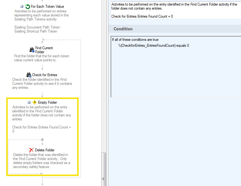

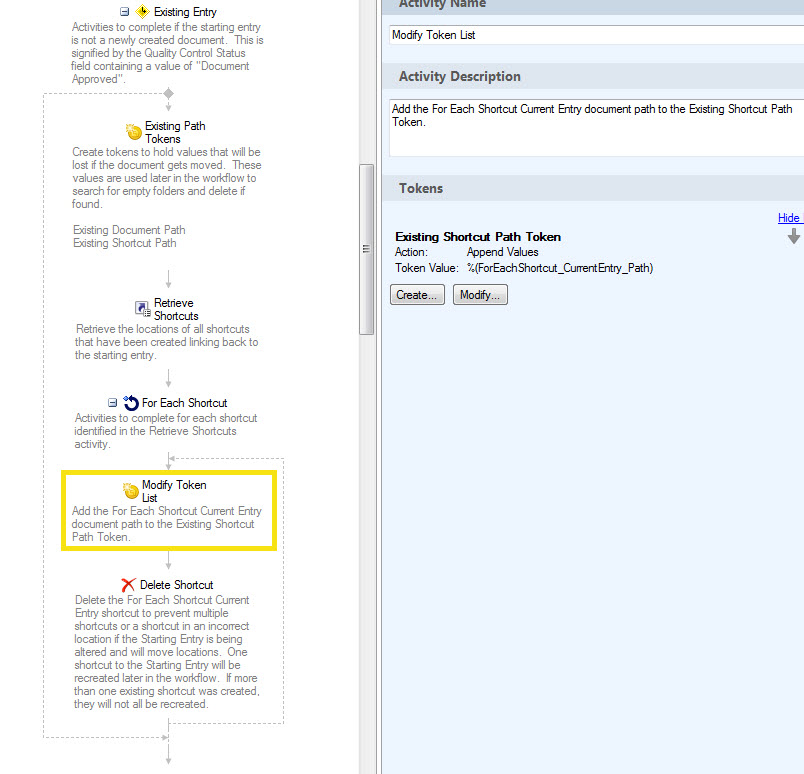

In my workflows, when I have shortcuts being deleted, I first find all shortcuts and put the shortcut paths into a token before deleting the shortcut.  At the end of the workflow I have a for each value activity that take each value in the shortcut paths token, checks to see if there are other entries in that folder and if not, deletes the folder.

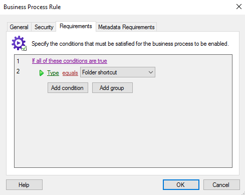

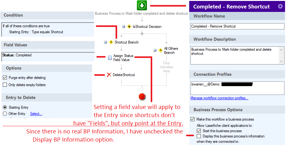

The workflow is doing exactly what you have told it to do.  Your start rule triggers on the Folder entry and not the shortcut (the shortcut is deleted because the entry it points to was deleted) because the metadata is not on the shortcut but on the folder entry.  When you access from a shortcut, you are still accessing the entry and not the shortcut.

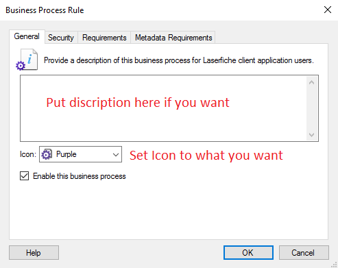

I think the best way to get around this is to use a Business Process.  So rather than trying to set a field on the "Shortcut", run a Business Process on it (the shortcut).
When you publish, if you choose not to display Business Process Information, you will get a warning, but just click the "Publish Anyway" button.  Then you will be prompted to log in and set Business Process Rules.
After setting the BP Requirement to be a Folder Shortcut, click OK to finish.
Then the next time users log into the repository, they will be able to select a folder shortcut and run the BP on it.

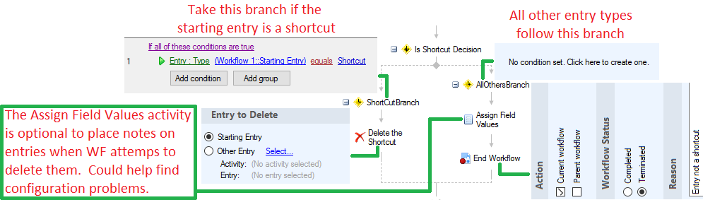

As a safeguard, you may want to implement a Conditional Decision activity something like this:
replied on May 27, 2017
Yes i used an Conditional Decision based on entry type to sure it work on the shortcut.
