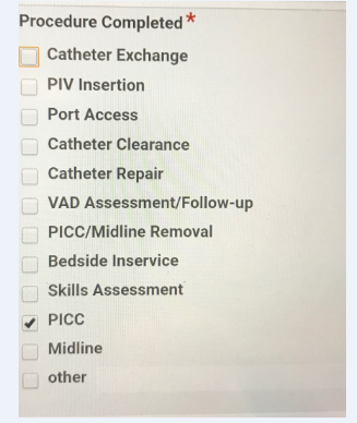

I have a user with a form that will occasionally prompt for a  required checkbox field to be filled in on submission. The problem is there is already a value in the field. Now the catch here is that this only happens when the checkbox is filled using a javascript that fills it out based on another selection. It doesn't seem to happen consistently as I could not recreate the issue.
Has anyone else ran into this? if so any suggestions on a work around?

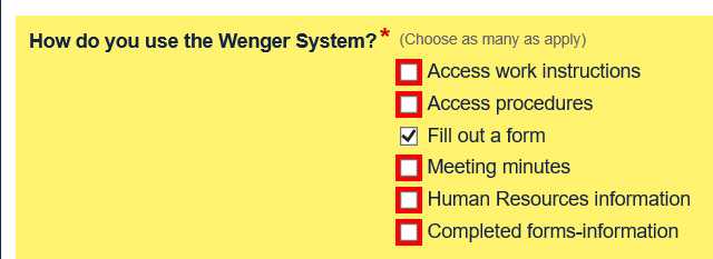

I have a required check box field in LF Forms 10.2 that when a user selects a choice then submits, it prompts the user to fill in ALL the check boxes.  Am I missing a setting somewhere to prevent this?
replied on June 5, 2017
If you are using 10.2.0.774, there was a bug that required checkbox field on IE11 compatibility view requires all options to be selected.
Applying https://support.laserfiche.com/kb/1013834/list-of-changes-for-laserfiche-forms-10-2-update-1- should fix the issue.
replied on June 6, 2017
Thanks, I'll look at updating to 10.2.1 update.
