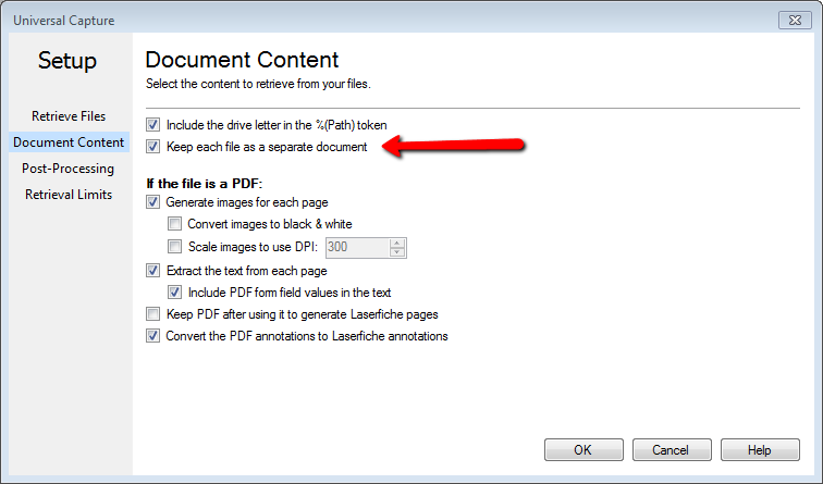

Ah I see. Yeah in your case, for the identification, since your documents are already split up properly you don't need to configure any identification processes - just check this box instead:
And then for the permit number, you'll want to OCR all pages and use pattern matching to search for the permit number on all pages of the document.
