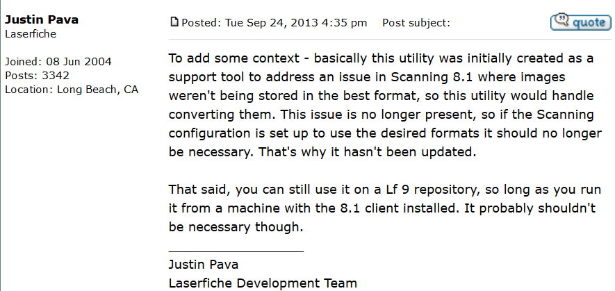

Here is the explanation to why they have not upgraded the utility.  It was cut from the old Laserfiche Forums.
replied on May 15, 2017
Bert, thanks for the explanatory reference!  At this point, I've tested Quick Fields 10.2 with some samples, and it looks incredibly fast.  You have to point to a folder, and can grab sub-folders.  It doesn't work on Search results, though.  So the methodology has to be folder based universal capture.  For example, I've got a folder with @ 800 sub-folders housing 162,000 pages in 3660 docs.  I would point to the top level folder, and QF would then process EVERY sub-folder.  There's no way to grab a smaller chunk.  I'm going to try it overnight on a top level folder with 22,000 pages and get an estimate on throughput.
