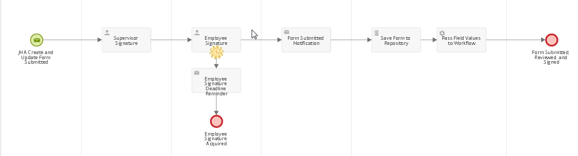

Here's a screenshot of the process:
After a supervisor reviews and signs the form, the relevant employee receives an email that their signature is required. For testing purposes, if they do not sign within 1 minute of receiving the first email, another email should be sent reminding them to sign the form. This reminder email should be sent every minute until the form is signed.

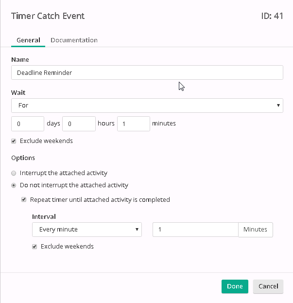

I created the following Timer Catch Event on the Employee Signature task:

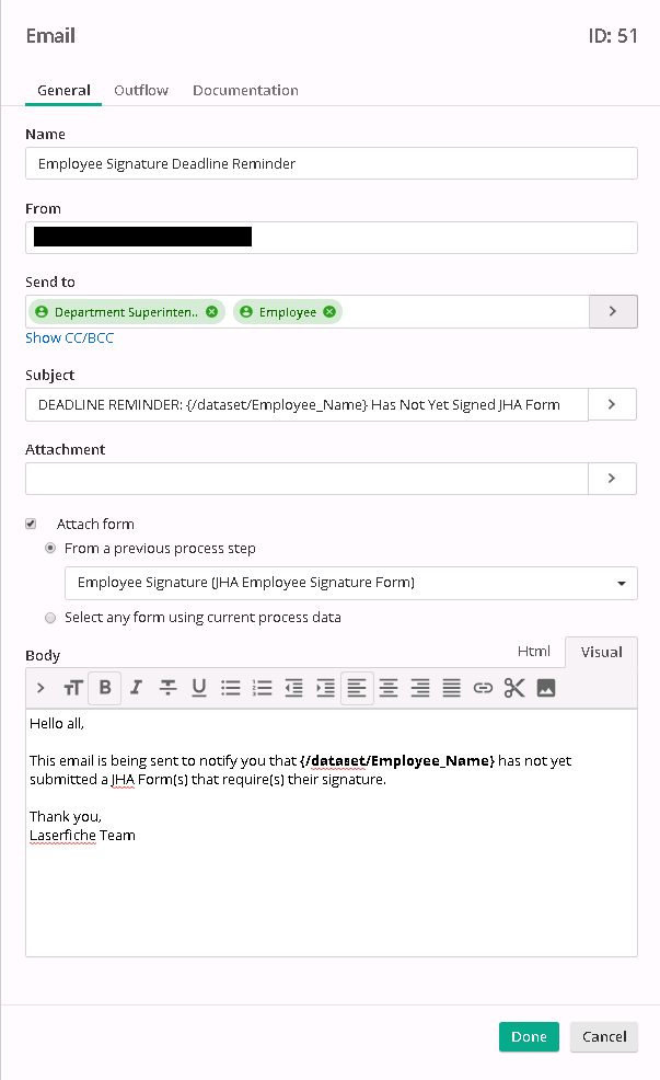

Here are the properties for the reminder email:

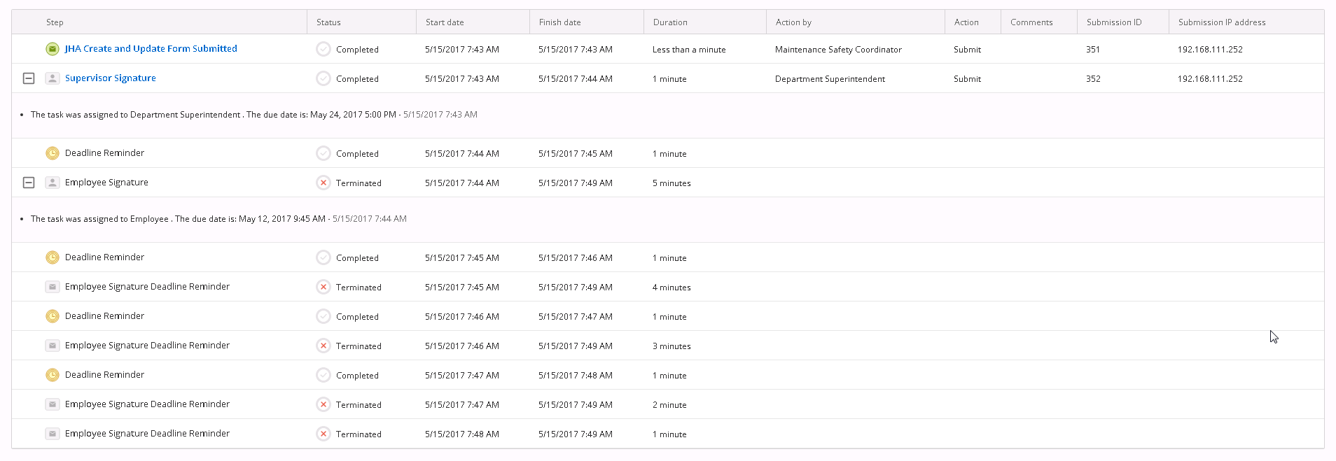

However, after initiating the process, providing the supervisor signature, and receiving the first employee notification email, nothing happens--the Instance Monitor just shows everything as suspended. The Timer Catch Events are triggering, but no emails are being sent. Here's an example (all items with "Terminated" status has a status of "Suspended" before I killed the process):

The timer seems to just be sitting there without a direction of where to go if the form is not submitted within time. You can write the email message within the process itself and use the Timer to re-route to itself if it's not submitted (see screenshot). Or if you want to keep it the way you have it, then simply drag the arrow from the Timer to the reminder email task and then from the email task back to the Employee Signature.
Right now it seems that you are simply sending the employee from the Employee Signature stage, to the Email Reminder and then Terminate.
So, try removing the "Employee Signature Deadline Reminder" task and adding the email message right into the "Employee Signature" task. Then use the Timer arrow to re-route to itself each minute. Remove the "Employee Signature Acquired" terminate event too.
