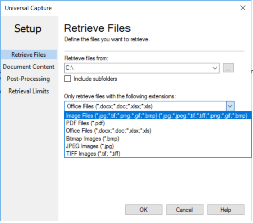

replied on May 10, 2017
Hey Julie,
It looks like the QuickFields Universal Capture scan source can only filter by file extensions in the drop-down shown below.
