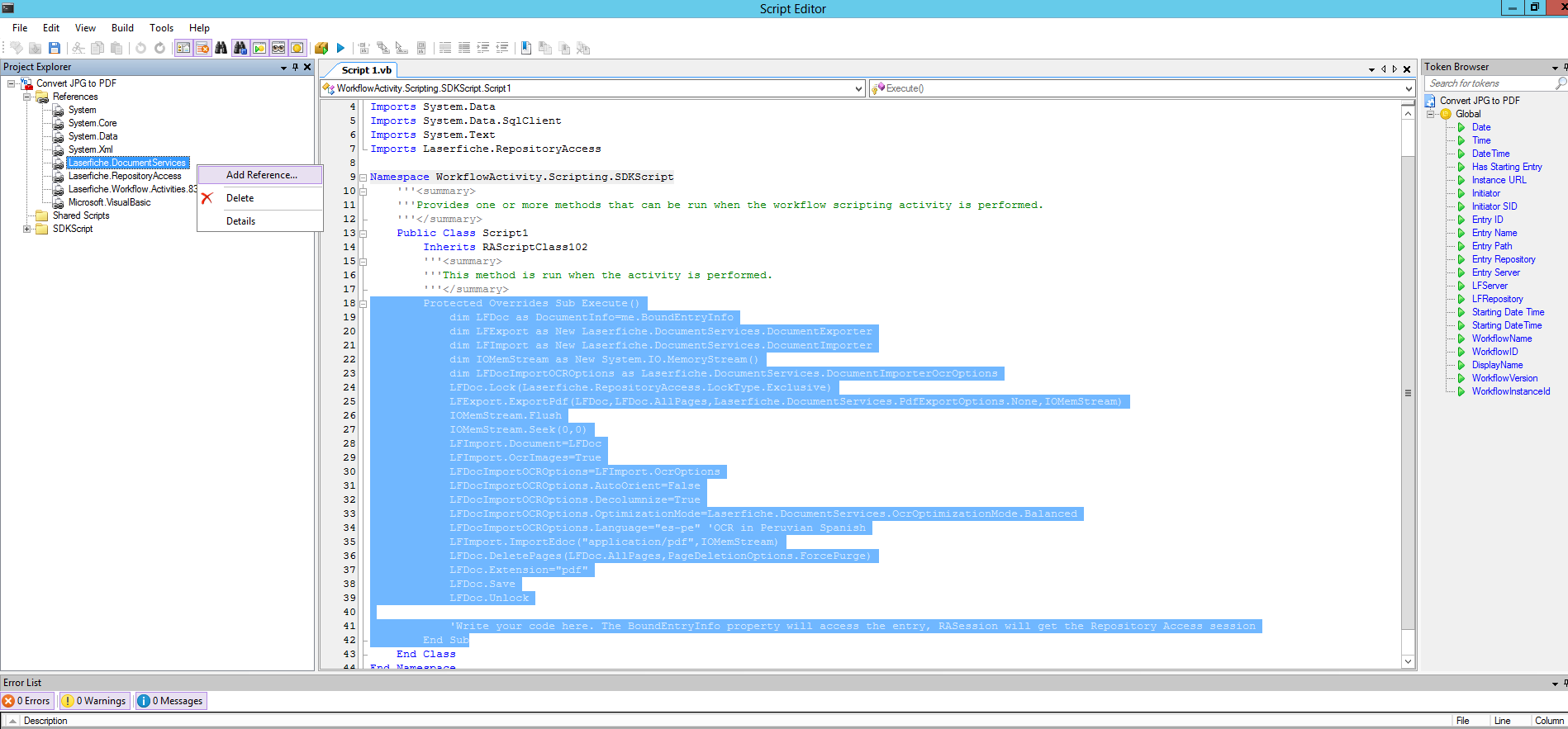

The solution will require the use of the Laserfiche API in a workflow.
This script, used in workflow, will convert a JPG or TIF to a PDF. Be sure to add a reference to Laserfiche.DocumentServices for it to work.

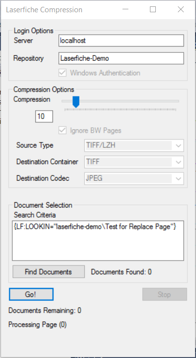

You can also use Laserfiche.Imaging.LfiImageConverter (part of the Laserfiche SDK) to convert between JPG and TIF.
I have some software written to do this kind of conversion. It's also great for compressing TIFFs (by converting colour TIFF-LZW to colour TIFF-JPEG.
Feel free to email if you'd like to know more. ben.birns@ingencia.co.uk. If you need it, I can add PDF support, too.

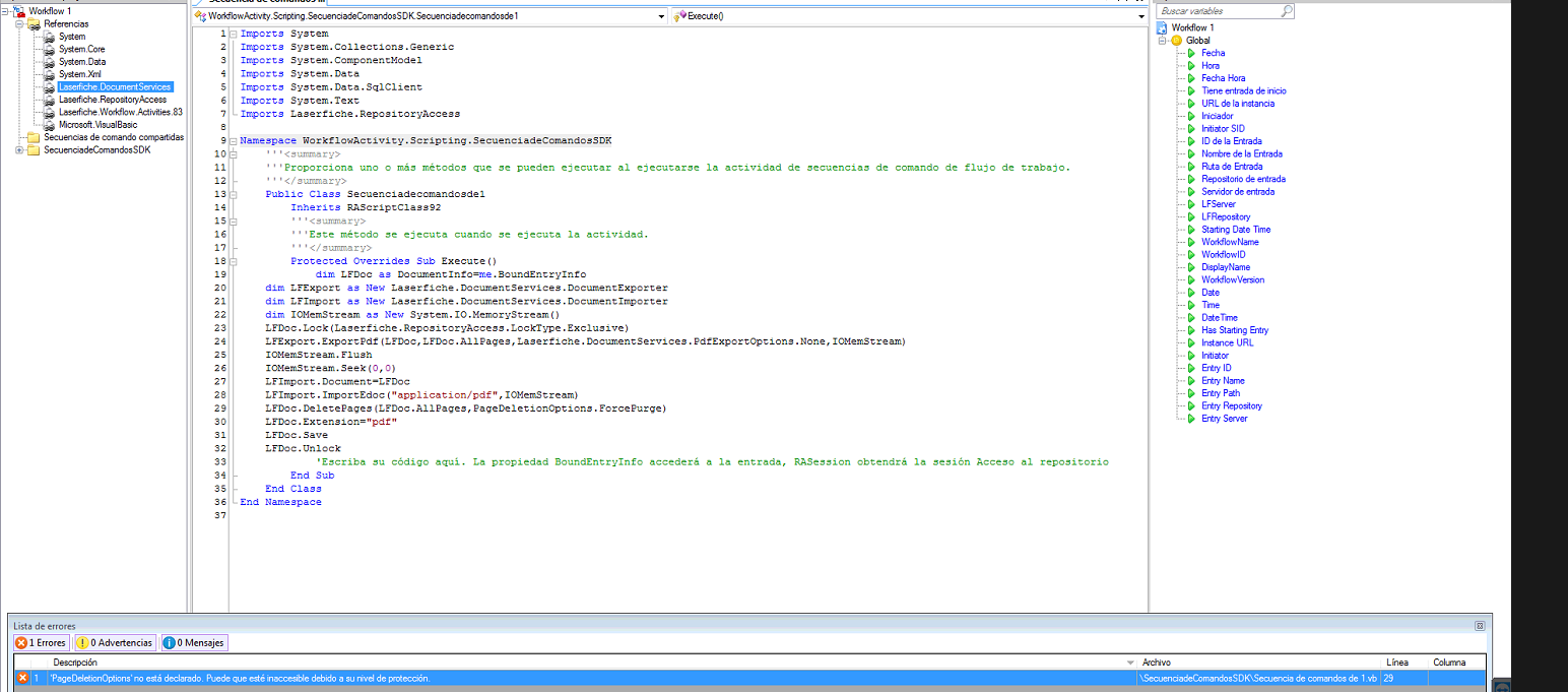

I generate the following error could you help me?
replied on May 23, 2017
You are using RA9.2 and Ben's sample was for RA10.  Basically, in 9.2, the DeletePages only takes 1 variable for the page range or page set.  So remove the PageDeletionOptions and you will be good.
LFDoc.DeletePages(LFDoc.AllPages)

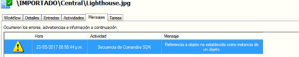

Estimado Bert Warren
Podrias ayudarme con este error

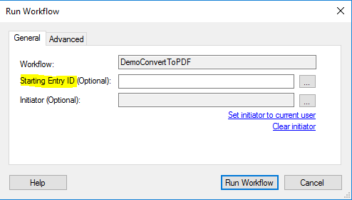

Your error is that the Document object is not set to an instance of an object.  My guess is that you are trying to test your workflow and you are leaving the Starting Entry ID empty.  The Starting Entry ID needs to be set to a valid Document ID that it can run the workflow on.

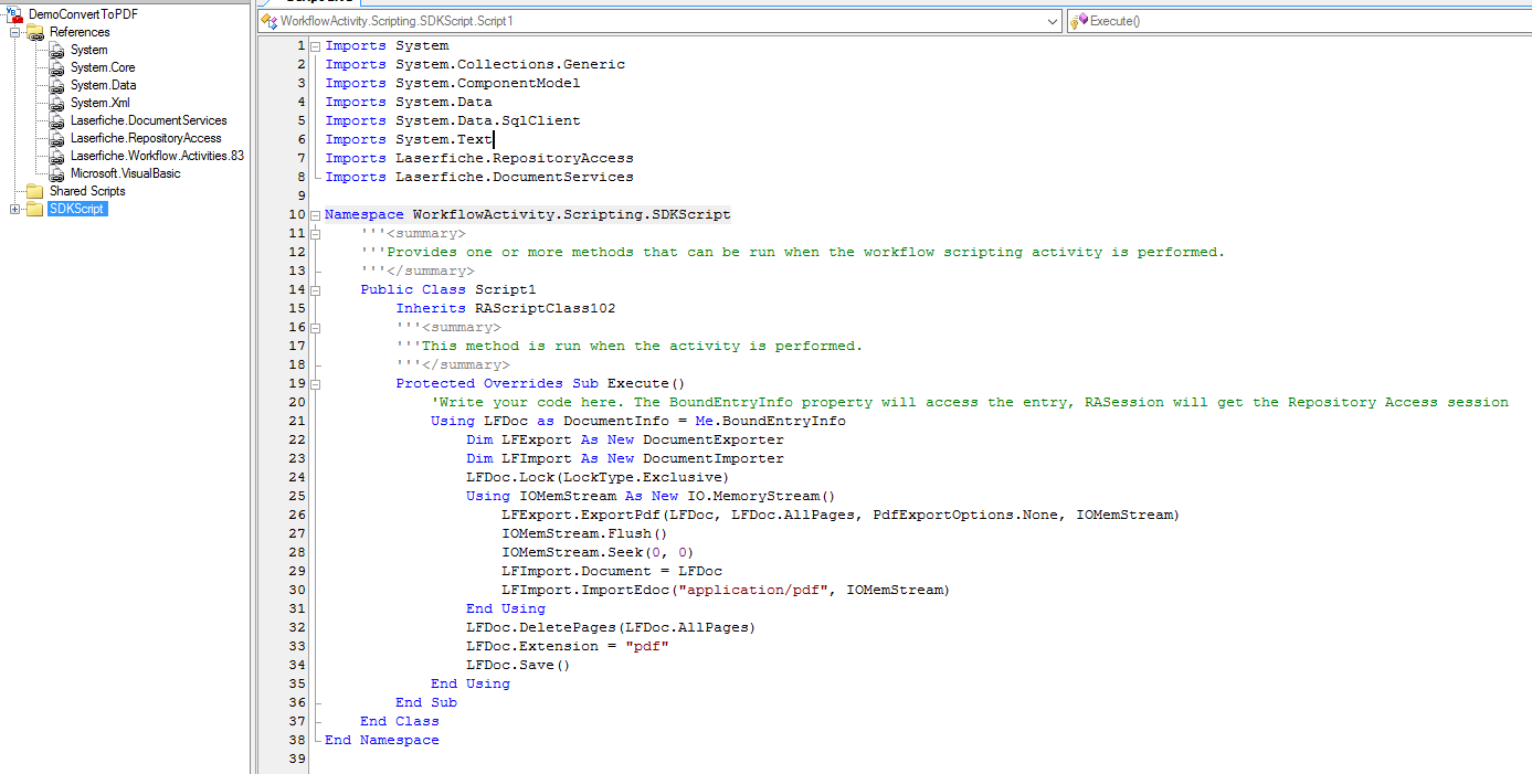

Here is how I would modify the code to make sure objects are being released properly.
