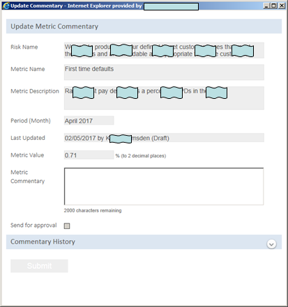

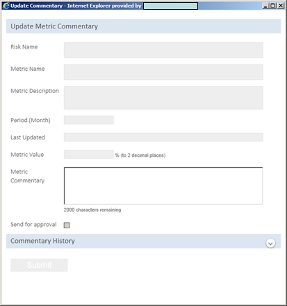

I have a form created that populates from a stored procedure. The data populates fine however as soon as it has populated it blanks out (see two screenshot). It is intermittent and has no pattern as to why it may be doing this. We are on Forms 10.1.0.642 ... Any ideas anyone please? Thanks

Yes there is a section at the bottom which has a few parameter fields and these two are in there ... they are both NOT read-only and text fields, yes it seems that RowID is populated or a while but Type ID is not then TypeID is populated and goes through the cycle again and the text vanishes. Really bizarre
