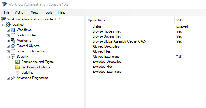

If you haven't already it might be worth checking the Security tab in the Workflow Administration Console to see what options are set under File Browsing:
I don't know whether Workflow/the script editor still use these constraints when run manually, but it might be something to try.

Thanks for that. I tried enabling the file browsing, but no change.
