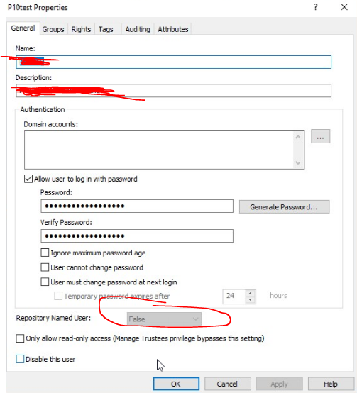

Is their a way to assign a Repository Named User System Manager Access?
I realize this is not a typical request but currently the Server is in the Cloud without a dedicated VPN where by the Server is not part of the customer's Domain and I / they want to be able to manager named User Licenses additionally we do not want public exposure so they can only access Web Access and Client / Admin Console

replied on November 1, 2017
Could you clarify this statement. We have a user(s) on an Avante System that have the Manage Trustees Privilege but cannot assign users a license unless they login as a system manager.
and the help documentation specifies that you need to be a system manager to assign a license
Just looking for clarification on how this should perform and determine from there if a support case needs to be created.

replied on June 2, 2017
This is still an issue. "Manage Trustee" does not seem to provide this ability. I even had the user login to the Admin Console using the built-in "Admin" Account but because they are not logging in as a Windows Account System Manager Functions are not available which seems to encompass assigning "Named User" licenses.
This is RIO not Avante.
Hopefully I am still just missing something.
