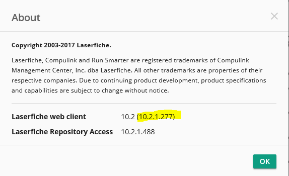

Our web Client shows 10.2 (10.2.1.177), are we on 10.2 or 10.2.1.177?
replied on August 31, 2017 • Show version history
Hi Khanh, you're on 10.2.1. You should be fine to apply the hotfix.

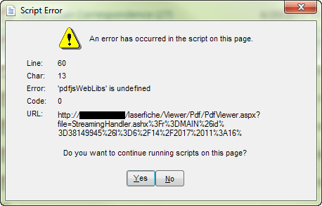

replied on June 21, 2017
Thank you, Ryan - we will double-check and try your suggestions again after hours. We backed off the hotfix this morning because it caused a "Script Error" on many documents (particularly those that appeared to not have "generated pages" done on them.)
Yeah, it looks like the Web Client is running into errors loading the JS for the PDF Viewer. One other thing that comes to mind- Are you currently on Web Client 10.2.0 or 10.2.1? The hotfix is specifically for 10.2.1.

Ryan, has there been a fix to the hotfix to correct the script error that Sarah was getting on her documents?
I would like to put the hotfix in place to stop using the workaround of downloading and printing (lots of local desktop cleanup involved with this) but don't want to introduce the script error to my users.
Please advise, thanks.
replied on July 14, 2017
The hotfix is safe to apply. We can't reproduce Sarah's issue internally with our hotfix. Multiple customers have applied the fix successfully, and this is the only known instance of someone running into trouble with it. To my knowledge, Sarah's organization hasn't reached out to open a support case through her reseller for the hotfix and she hasn't replied to my post earlier, so I can't speak to the issue she was experiencing.
Just make sure when you apply the hotfix, you're specifically on 10.2.1 (not 10.2.0) and that you swap out the entire 'Viewer' directory. If you do run into any issues with the hotfix, ask your reseller to open up a support case and we'll fix any problems that occur.

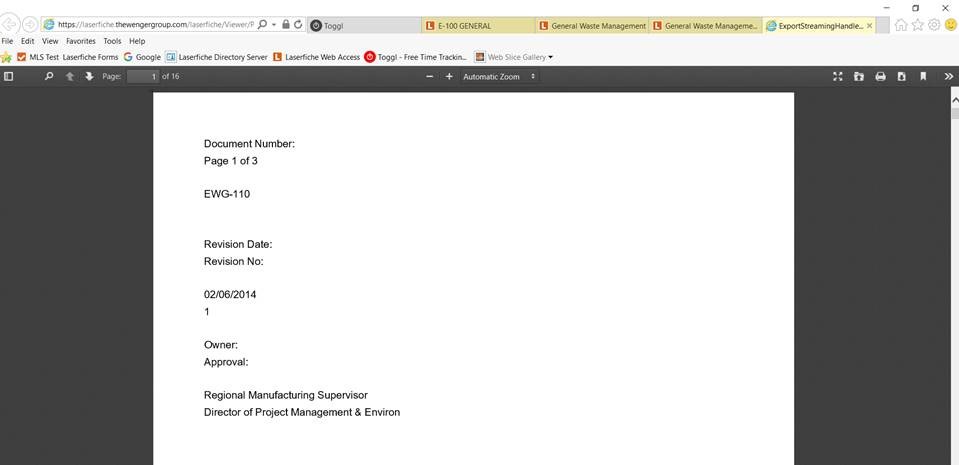

KB 1013894 Patch applied, still NOT workingangry .  Printout still got cut off; only 1/4 of page is printed, header (ExportStreamHandeler.ashx) and footer (File/server path) embedded on the printout.  Chrome and FireFox have no issues.
I doubt if version 10.3 will resolve the IE printing issues if pdf.js method is still being used starting with Web Access Version 10.2.

see attachment, I hope it helps. Most of our users are on IE and have Adobe Reader by default so the download button works great for us.
replied on June 20, 2019
As of today we are on the latest Laserfiche Web Client 10.4 (10.4.0.309) and issues still exist with Internet Explore Browser.  The workaround is to download the document then use Acrobat Reader to print.
