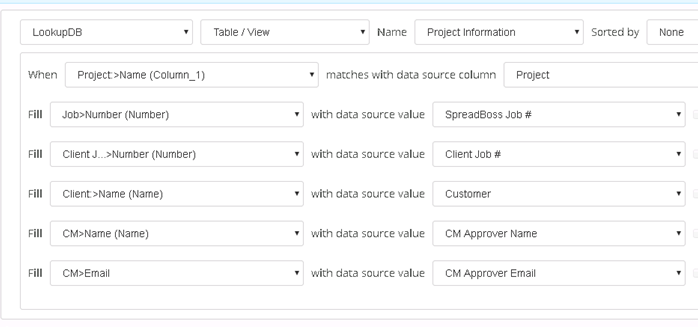

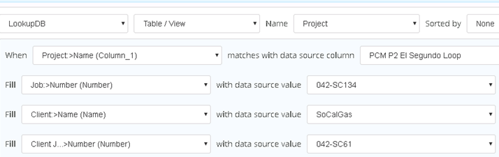

 I am creating a form for my employees out in the field that work on several projects. I would like to make things a little easier by having the form auto fill once the project is chosen. Each project has its own job number, client and client job number. I created a database for the Lookup Rules to be applied for each category. I am not sure if the fields should be single fields or if it is okay to use tables/drop downs. See below.
This is how I set up the Lookup Rules.
Your help is greatly appreciated.

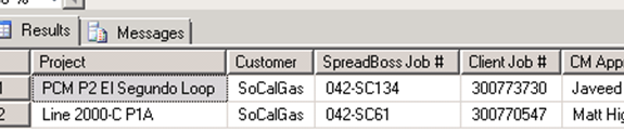

I listened to what you both were telling me and I came in this morning ready to go. I read how to create a database containing columns, rows, data type etc... and what they mean. I then deleted the previous table and created a new table with the columns as labels and the rows that held the information. Once I did this then I went in and refreshed my data source in forms which allowed me to use it in the lookup Rules. See below
IT WORKED!!!

It didn't change anything. Does it look right?
replied on April 28, 2017 • Show version history
It does. And, if it is,  the Column_1 drop down should  should be populating with all of the fields that are in your Db table column named Project.
Then your second rule should populating the rest of your form based on the user's selection in the drop-down.

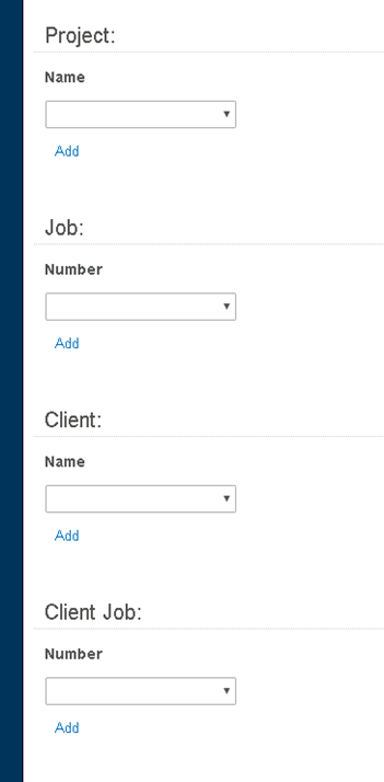

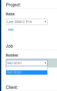

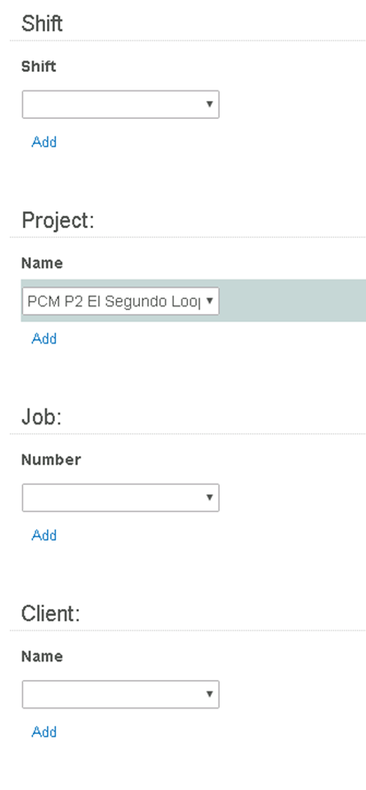

Now I see that once I choose a project and it fills in the information, it will not allow any of the other auto filled fields show their drop down options and if I need to add another project all of the other fields are blank.
adding another project shown below.

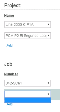

Under Name you have 2 separate drop-down lists with different values in each, Line 2000-C P1A and PCM P2 El Segundo Loop. Normally I would expect to see both of those choices in one drop-down.
Are you wanting to reference more than one Project name on the same form? If so, you would need to move these to a collection, I believe.

That's strange, your value is your column's name...
Can we see your database? (with some data)
replied on April 27, 2017
I built a sample database to work with.
Do you have some records in your "Project"?
I'm not sure what you mean some records.

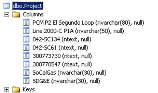

As above in our other conversation. What you have named your columns, I believe should be your records. Your column names would be named something like: project_name, client_name, job_number, etc
replied on April 27, 2017 • Show version history
Your "Project" is a database, right?
Is like an Excel's file ; it's a spreadsheet.
You should have some records like this :
PCM...   |    Line    |    042    | ....
record 1 | string1 | string 2 | ....
record 2 | string 11 | string 22 | ....
Gina, right click on your "dbo.Project" then clic "Select Top 1000 Rows"
You should see yours records
This is mine ; you can see 3 records

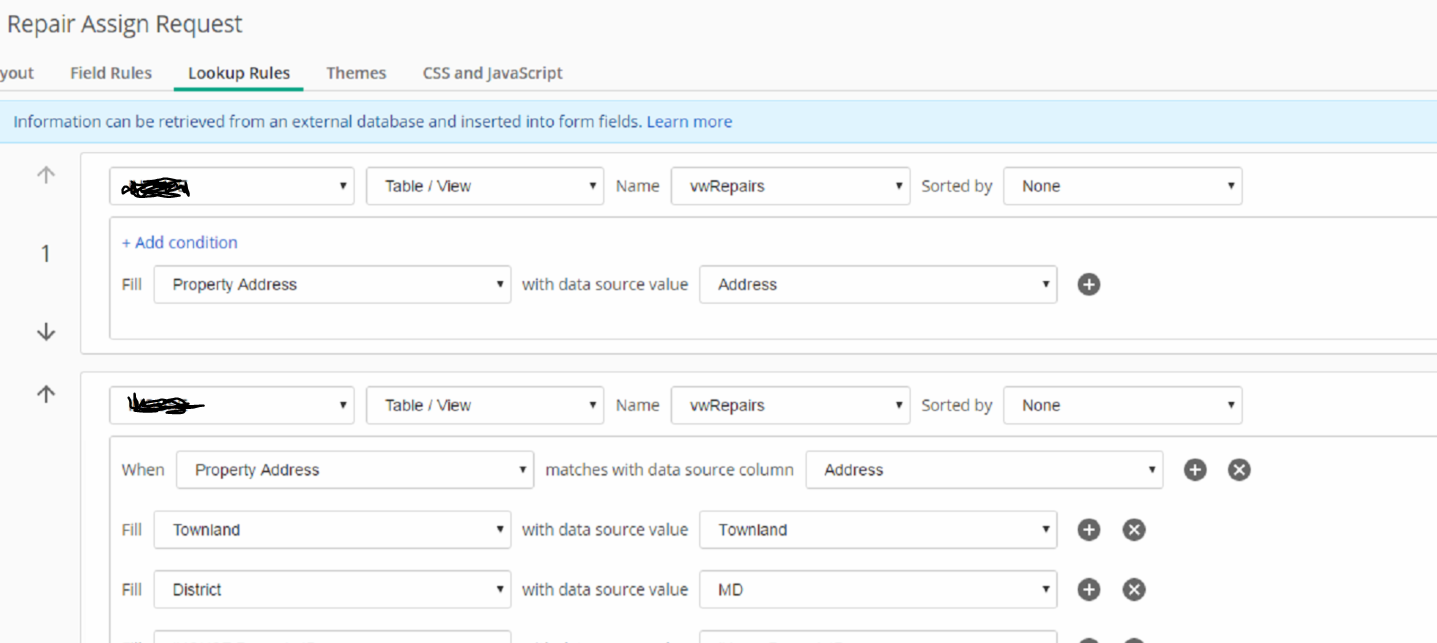

You need to first populate the Project Name field before then matching with the WHEN condition to auto-fill the remainder. See example attached for a repairs database.

The IT guy showed me how to build a database the other day and I added a new table with columns. as seen below. Is this my problem?
I read in laserfiche answers that I should create a separate database outside of forms in case I upgrade and the new upgrade has a database built in it already.
In my mind, it looks like a Access' file, right? I just need to know if you have records inside.
In your form, your value = "PCM P2 El Segundo Loop" ; this is your name's column, not a value. So I think you have no records in your database, that's why yours fields is not auto populate (or if you prefer, is populate with "nothing")
Your best option is to insert a new first rule which is Fill Project Name = PCM P2 with no 'WHEN' condition.
