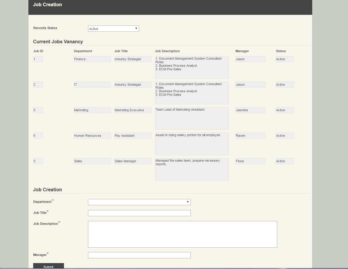

I need to retrieve a list of records from SQL tables and display it in a table in a forms. But i only wish to display those records status that is active. How do i achieve this using javascript?
I had attached a screenshot of my forms.

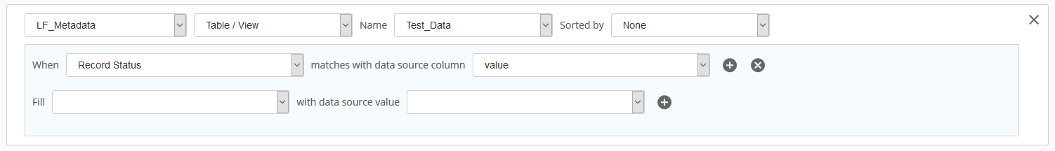

Do you need to use JavaScript for this? You could add another field to your form called "Record Status" and set the value to "Active", then specify this field in the "When" option in the lookup rule:
This will filter it to only include active records. You could even make the Record Status field a drop down so you can toggle between Active/Inactive records.
Cheers, Dan

really appreciate your advise on this. It work perfectly. But i got another questions.
As you can see from my attachment. I'm thinking of adding a feature in the form to be able to delete a records / update the status for the records in this form. This will also require to update the database table as well.
Do you think is possible to achieve this?

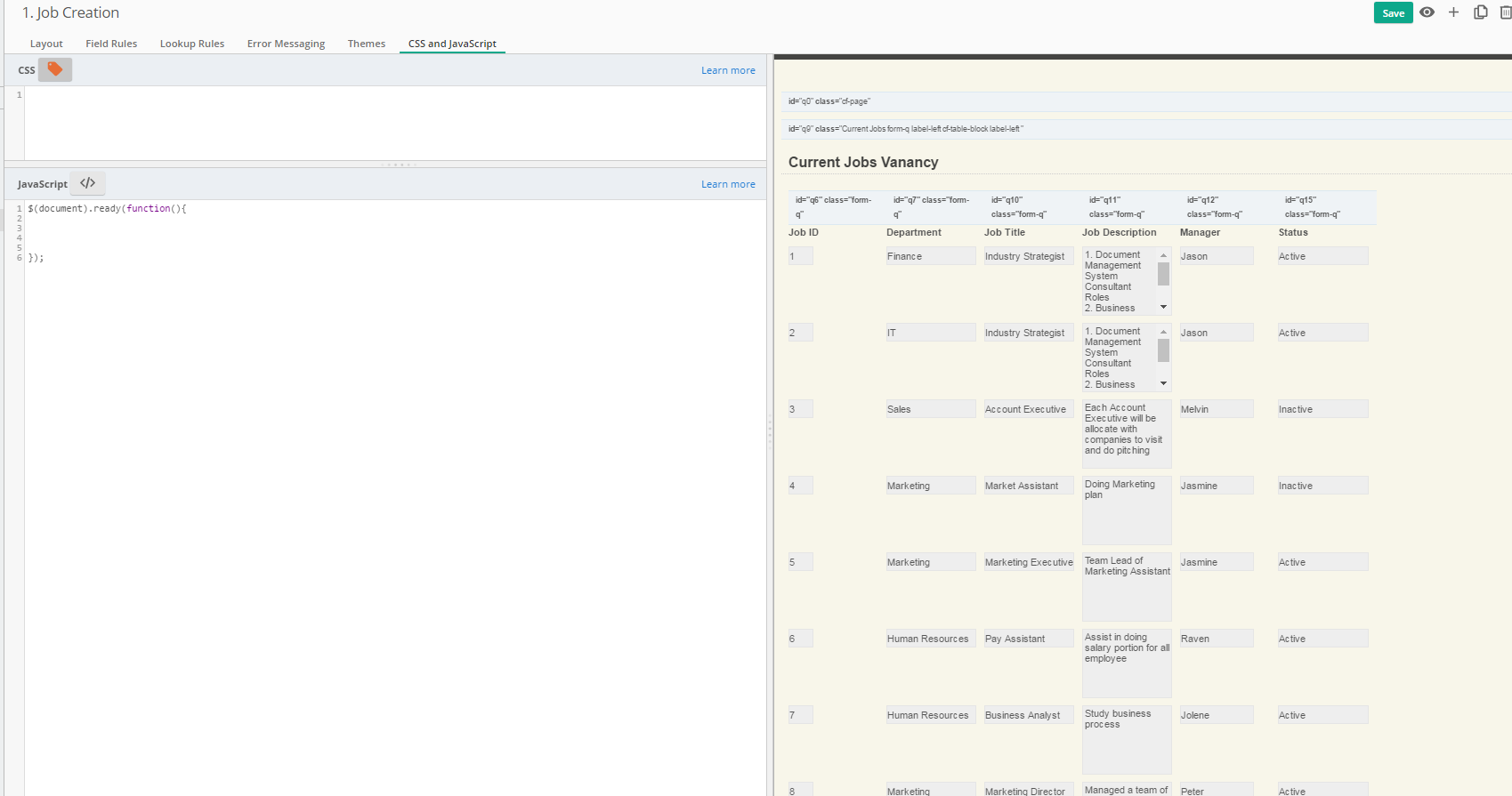

Yes. I can create a dropdownlist column for each records. But how do i trigger workflow when i update the column? Cause there will be no submit button to trigger
replied on April 27, 2017
Ah, that makes it a bit more tricky. In that case you would have to use JavaScript, probably to send an AJAX request to a server page. Unfortunately I don't know enough about this to comment further... Sorry!
