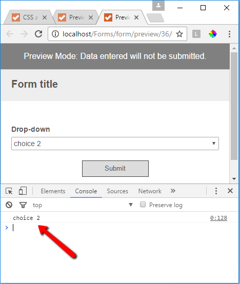

Your original code works perfectly fine for stand-alone dropdown fields. See below:
  console.log($('.someclass select').val());
Result:
